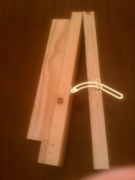

I am making a coffee table and the legs have beveled feet.
The wood is 3 1/2 inches wide and the cut is 1 5/8 of the bottom and 4 1/4 on the side. (I hope this makes sense...if not, I can post a picture)
My miter gauge only goes to 30 degrees so I can't make the cut with just that on my SS table saw.
Any suggestions? I don't have (or have access to) a power miter saw.
Thanks!
Morgan
Blue Springs, MO
SS Mark 7 PP
Most folks make this cut using a rip fence with a jig to set the wood at the proper angle.
http://www.newwoodworker.com/usetaperjig.html
Just google "ripping tapers on a table saw" and you'll get lots of ideas.

charlese wrote:Most folks make this cut using a rip fence with a jig to set the wood at the proper angle.
Well, she's not the prettiest gal at the ball, but I think she'll do the trick!
Thanks for pointing me in the right direction.
Morgan
Blue Springs, MO
SS Mark 7 PP

That looks right to me. It's a jig not a piece of furniture.:D

Hey Morgan! - Looks good to me - even adjustable!!! Nice work:D

WOOD there be any advantage to making it so it saddled over the fence?
wrmnfzy wrote:WOOD there be any advantage to making it so it saddled over the fence?
Depends on the operator's preferences. Also the builder's desires. This jig is only going to be used occasionally. There would be no advantage for me to have it saddle the fence.
