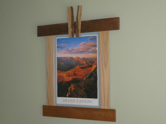

nuhobby
Posts: 2366
Location: Indianapolis
Post by nuhobby »
I've used some small walnut branch re-saws for decoration, like this. That branch fell off a dear tree near my house, and I hated to see it just go to trash....
[ATTACH]18485[/ATTACH]
Picture Frame.jpg (25.09 KiB) Viewed 2349 times
Chris
