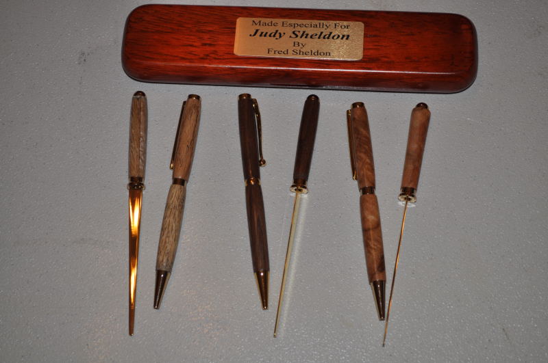

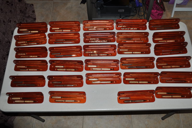

Ok, pictures are optional but appreciated. I just finished packaging up 35 Pen and Letter Opener sets for Christmas Presents.
[ATTACH]18958[/ATTACH]
[ATTACH]18959[/ATTACH]
- DSC_0297.JPG (125.09 KiB) Viewed 3020 times
- DSC_0303.JPG (88.92 KiB) Viewed 3026 times

I am inpressed
I agree. Thought I did well to get 20 made- without boxes but you sure surpassed me. Getting started was the major part. The first one I made was a stylus for my neighbor. He appricated the workmanship but did tell me the whole thing was too short for him to grip and to see just which key he was hitting. I since learned the turning part could have been made longer by using a different brass liner- oh well next time.pennview wrote:Nice work there, Fred. I'm sure those give will be greatly appreciated. Those personalized boxes are a nice touch.
