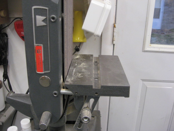

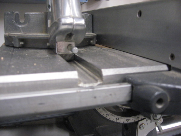

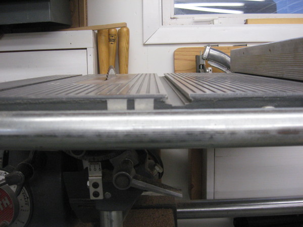

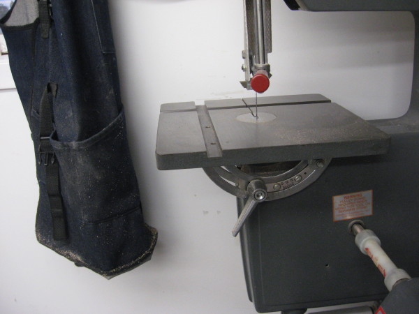

pictures of tables
Post by oldc6 »
a few pictures ----------a 500 table with no groove. 505,510,520 has slot . picture is of a 510 table.
cast iron bandsaw table,[ATTACH]18608[/ATTACH]
[ATTACH]18609[/ATTACH]
[ATTACH]18610[/ATTACH]
[ATTACH]18611[/ATTACH] and belt sander table do not have grooves either,
