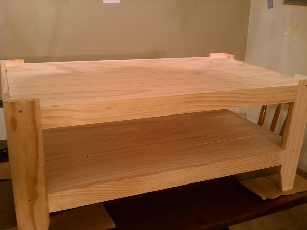

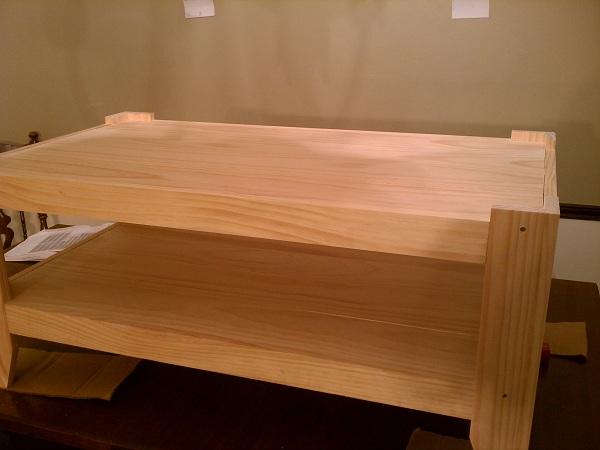

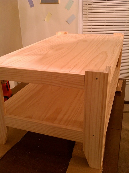

Not quite done (still need to attach the side rails <pocket screws and the nails that started this thread.>) but I think it looks pretty good...
