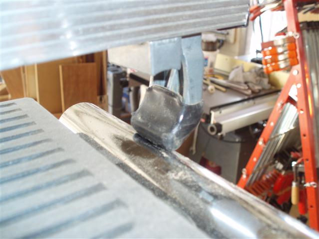

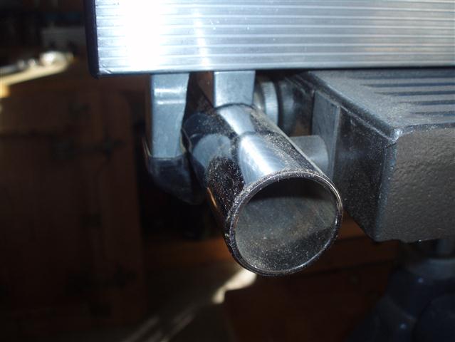

mrhart wrote:While doing the latest project, I checked my fence to keep it square to the blade but the lower lock always throws the opposite end of the fence to my left. This is annoying when setting up for a precise cut. The top lock (back) just holds it where ever the lower (front) lock tells it to. I started noticing that the lock does not keep it square a great deal of the time, so I must check every single cut for square. (thats not right) I know I can adjust the spring tension but how can this be adjusted to where when you lock it, its square? Isn't that one of its primary functions??
As statesd, the bottom lock should square the fence with the table (in accordance with the way it was aligned!!!). The upper lock should then secure the outfeed end of the fence WITHOUT MOVING IT.
If it moves when you secure it, or does not secure properly - you have maintenance to do.
The first thing that I would suspect is the rubber boot on the lock bar.
[ATTACH]19182[/ATTACH]
[ATTACH]19183[/ATTACH]
- 015 (Small).JPG (47.85 KiB) Viewed 3703 times
- 018 (Small).JPG (35.87 KiB) Viewed 3703 times
