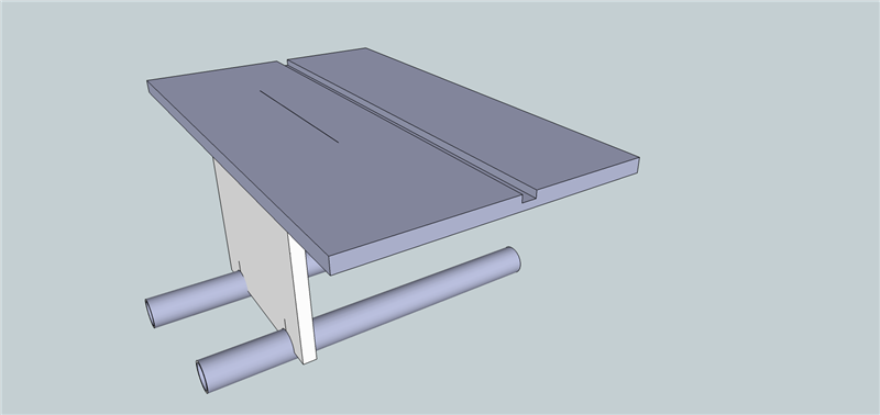

I have a Sharpening Table that is very much the same as that in the link above but mine does not rely on the extension table. It rests on the left side of the headstock.
I just realized that I do not currently possess this table. I loaned it to someone at a turner's club meeting I attended and I don't remember to whom.
[ATTACH]19925[/ATTACH]
- Chisel Sharpening Station (Custom).png (56.96 KiB) Viewed 3766 times

I like your idea what keeps it from moving?dusty wrote:I have a Sharpening Table that is very much the same as that in the link above but mine does not rely on the extension table. It rests on the left side of the headstock.
