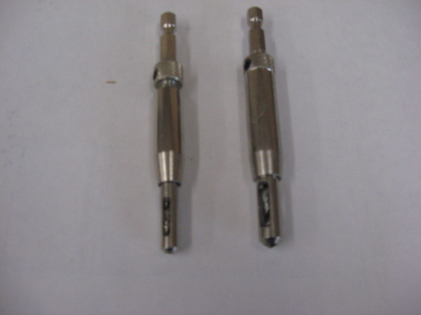

drilling hinge holes
Post by oldc6 »
Will throw this into the post also. Some may not know about these tools
Self centering drill to make screw be exactly in center of hole......[ATTACH]20124[/ATTACH]

oldc6 wrote:Will throw this into the post also. Some may not know about these tools
I believe these are essential tools for drilling the pilot holes for any small flat head screws. I use them for door striker plates and door knobs, piano hinges, and anyplace where the screw must be centered in a recess.
