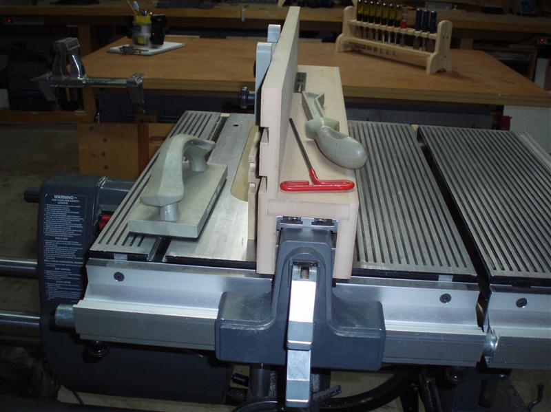

You can either build that fence as suggested in PTWFE or build in in a h shape which is what I have done.
The sacrificial fence straddles the rip fence but fits tight enough that it becomes almost one with the rip fence. If needed, the t-nuts can be used to secure the sacrificial to the rip fence either in the side or the top T-slots.
[ATTACH]20322[/ATTACH]
[ATTACH]20323[/ATTACH]
- P2060001 (Small).JPG (53.2 KiB) Viewed 10590 times
- P2060002 (Custom).JPG (75.34 KiB) Viewed 10593 times

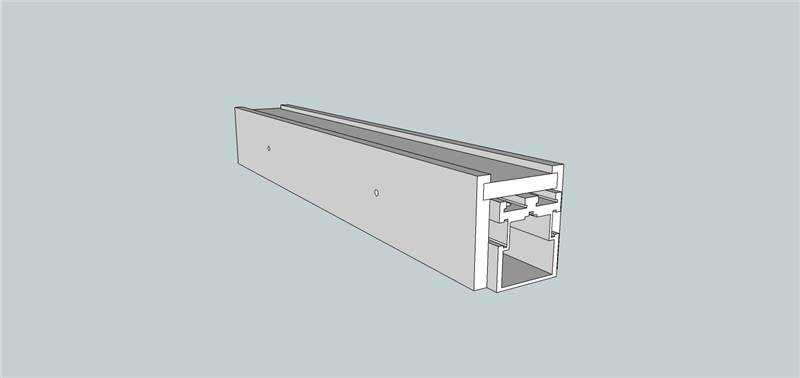

I'd secure the sacrificial fence (built to wrap the rip fence) using the Shopsmith t-nuts.
A picture rather than a lot of words.
[ATTACH]20347[/ATTACH]
The t-nuts could be used in the tracks on top of the fence, if you preferred, to avoid any interference with the smooth face of the fence. Mine are counterbored to provide the required clearance.
- Rip Fence with Sacrificial Fence (Custom).png (35.92 KiB) Viewed 10462 times
