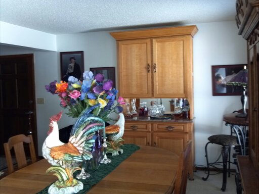

I just finished building a bar for the dining room. Actually, I copied, and adjusted to my needs, an 18th C. hutch with a granite top the separates the bottom from the hutch/cupboard above. In any event, I built it out of quarter sawn oak. The wife wanted it to match the old antique oak pieces she has in the dining room, all golden oak. I hunted around and settled on a finish system sold by General Finishes http://www.generalfinishes.com/sites/de ... rbased.pdf.
I ordered Seal-A-Cell, and Arm-R-Seal oil & urethane topcoat, plus a stain from Rockler. Man, I loved it. Nicest finished I've worked with in a long time. If I knew how to post pics here, I would post one of the hutch.

Please Post Pics, we'd love to see it.WmZiggy wrote: If I knew how to post pics here, I would post one of the hutch.

Ok, here goes a first and thanks for the link on how to post pics.
[ATTACH]20754[/ATTACH]
This pic includes my wife's grandmother's dining room table about 100 years old. The hutch I started in November and finished in February. I installed LED lights, to include colored lights in the hutch area. I used glass shelves in the cupboard, and backed the upper cupboard with mirrors. There is alot of SS in this cabinet.
- 1364485416484.jpg (39.64 KiB) Viewed 3663 times
