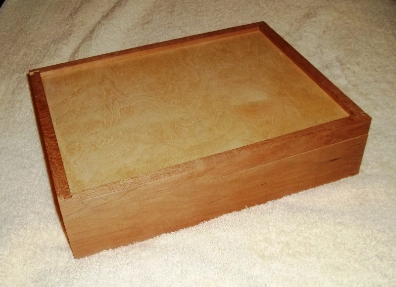

So I built a box for my doweling kits:
[ATTACH]20837[/ATTACH]
It is a cherry box with birch paneling inserts and the two shorted eggcrate-type dividers are walnut. (I used what I had laying around.)
This is the first time I built a box and then cut the lid off on the tablesaw. So that was a bit new for me. It has both top and bottom panels floating in grooves in the sides.

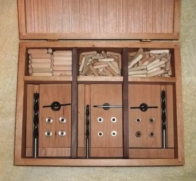

[ATTACH]20838[/ATTACH]
Then I cut little pieces to fit inside. Lesson to learn here is to start with the biggest kit first (the 3/8") but I didn't have one yet (out of stock at HF). No problem, just used the cut offs to make spacers.

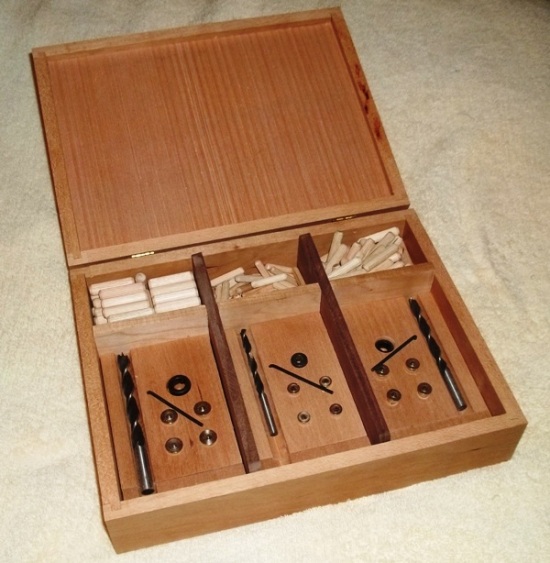

Anyway, now my little dowel kits have a decent home and won't get lost in a drawer or toolbox.
[ATTACH]20839[/ATTACH]

Very nice little box there. Curious how you made the parts that hold the drill bits and such.

algale wrote:Very nice little box there. Curious how you made the parts that hold the drill bits and such.
I made the groove for the bit with a box core bit in my router table, starting with a piece long enough to do all three sections. I used the brad-point drill bits from the sets to drill holes for the centering things. Used the calipers and my forstner bits to drill holes for the collars. Pretty basic but functional.
One trick was to get the dividers tall enough to reach the bottom of the lid so that the dowels don't get all mixed up if the box gets knocked around.

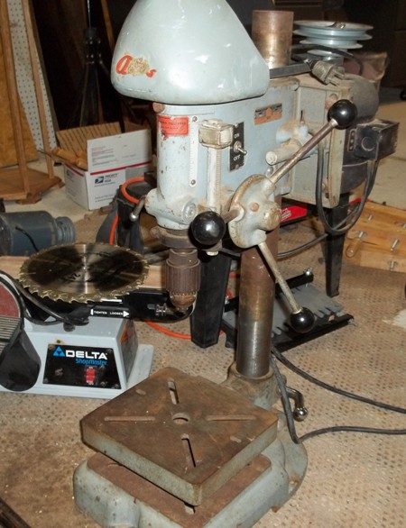

Sure enough, I have a dowel jig. It is an old Stanley 59, still in the original box. Guess I'll have to make a bigger box to include it. I also was thinking about my set of stop collars, but I guess it would make more sense to incorporate those into the drill press table I want to build for my '58 Atlas benchtop drill press.
[ATTACH]20874[/ATTACH]
It's a brute, but I fell in love with it after nearly breaking my back trying to get it out of the back of my truck by myself. I swear the thing weighs as much as I do. I'm in the process of cleaning it up and bringing it back to its former glory, just like my '55 SS.

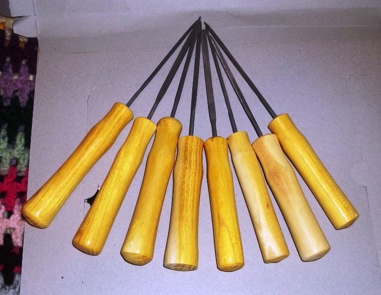

Meanwhile, here's another little ongoing project. I bought an el cheapo set of HF files, but they had no handles which makes them a bit uncomfortable to use for very long. I have some bois d'arc that came out of the woods behind the house that I had cut into pen blanks. And I always love any chance to get some practice in on the lathe, so....
[ATTACH]20875[/ATTACH]
