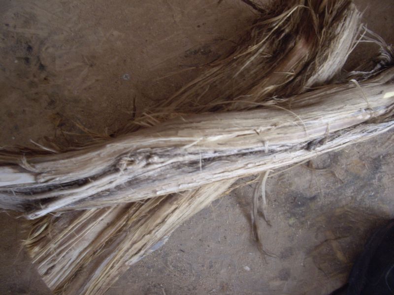

After I innocently commented to my 1/2 bro., while hiking around his area of WY, that I wondered how those huge sage brushes would work up, he cut a large chunk of a trunk for me.
This first picture is what I started with. Nasty stuff![ATTACH]20960[/ATTACH]

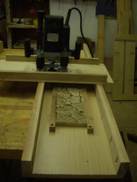

After cleaning it and slicing it into "oysters", they were glued on to a piece of scrap 3/8 plywood and leveled with a quickie router planer jig. [ATTACH]20961[/ATTACH]

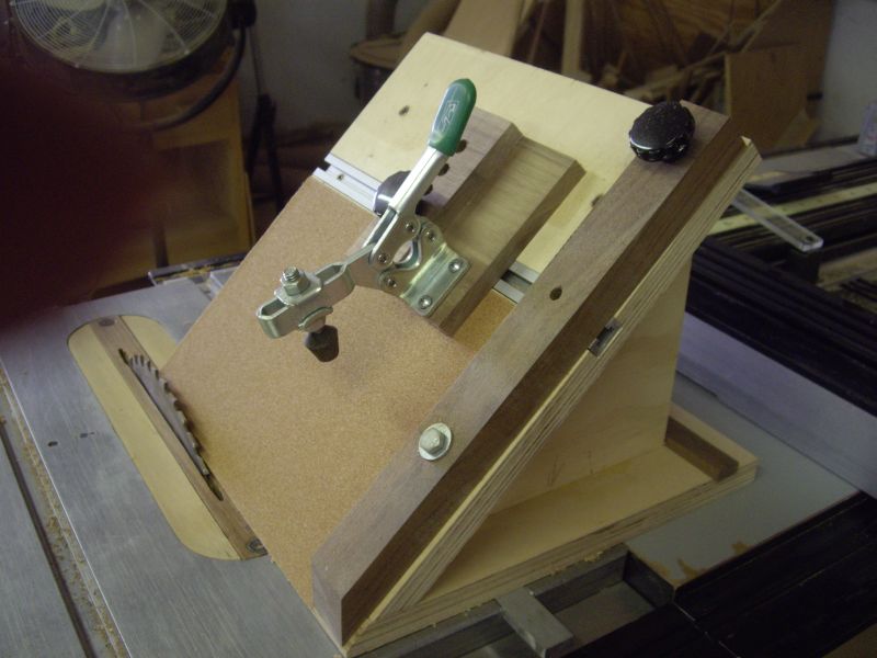

Since I detest moving the Jointech and replacing the table so it would tilt, I made this jig to cut 45s without the hassle.[ATTACH]20962[/ATTACH]

- Router Planing jig.jpg (63.46 KiB) Viewed 2765 times

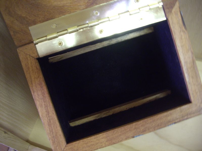

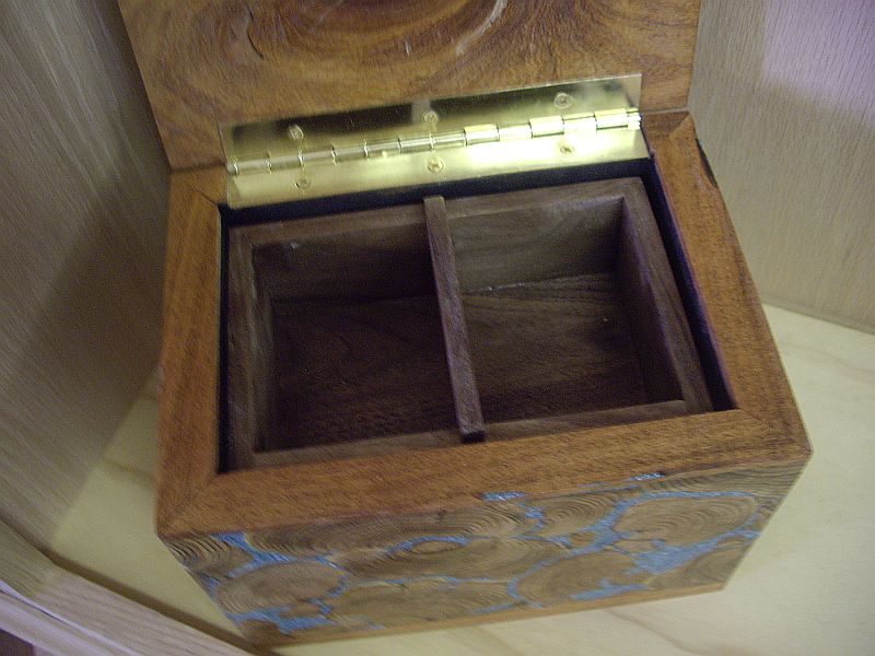

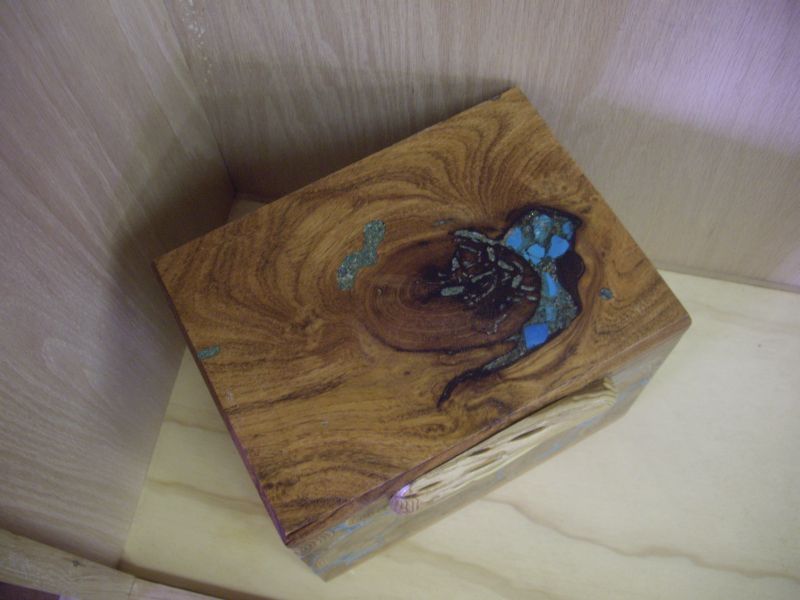

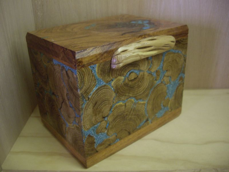

That jig worked beautifully.
Here are pics of the finished Oyster Box.
The lid and bottom are mesquite. As is the top of the opened box.
The tray is scrap walnut and the runners are pin oak.
The box measures 8" wide by 6" deep and 6 3/4" high. The box sides measure 3/4" thick. The interior is flocked black.
This was fun. I think the next one will be deer antler "oysters".
