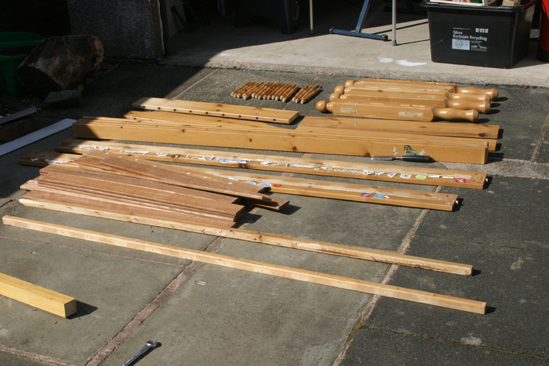

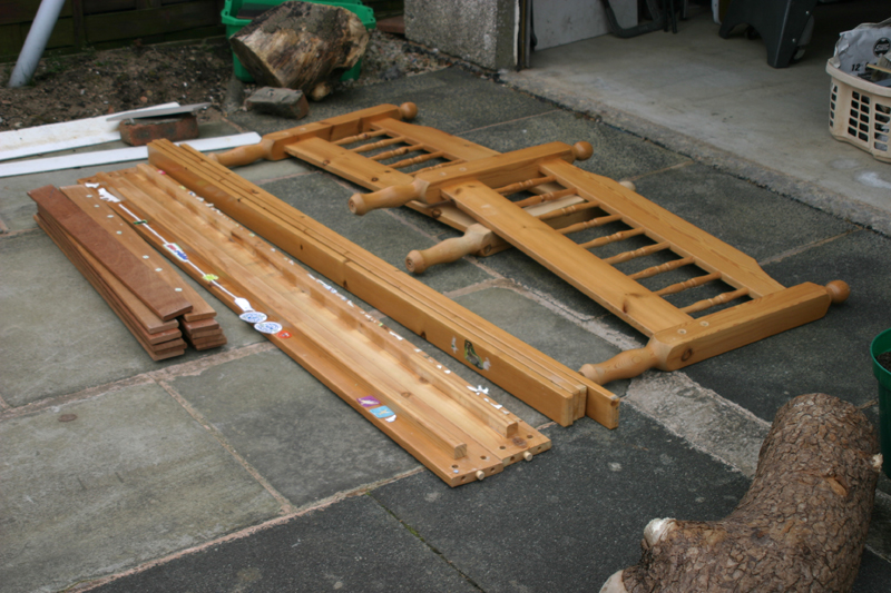

Before I could do any design I had to work out what I had available & measure up the bed wood - this is the raw material complete with a vast number of stickers, courtesy of number 2 daughter! Took me ages to scrape them off :(:
[ATTACH]21077[/ATTACH]

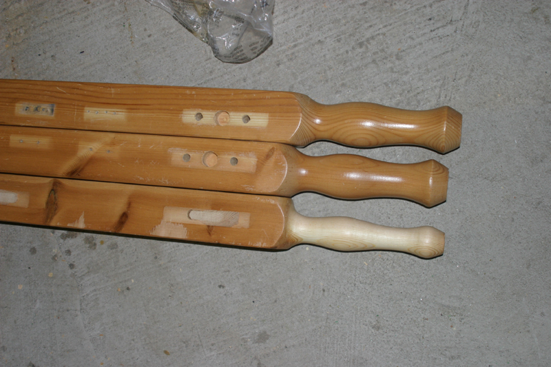

and after breaking it down:
[ATTACH]21078[/ATTACH]

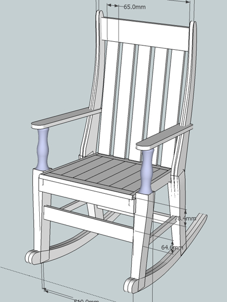

So I was then able to put something together in Sketch-up:
[ATTACH]21076[/ATTACH]
Which amazed me because it actually looks quite acceptable. Whether the build will be acceptable remains to be seen!:rolleyes:

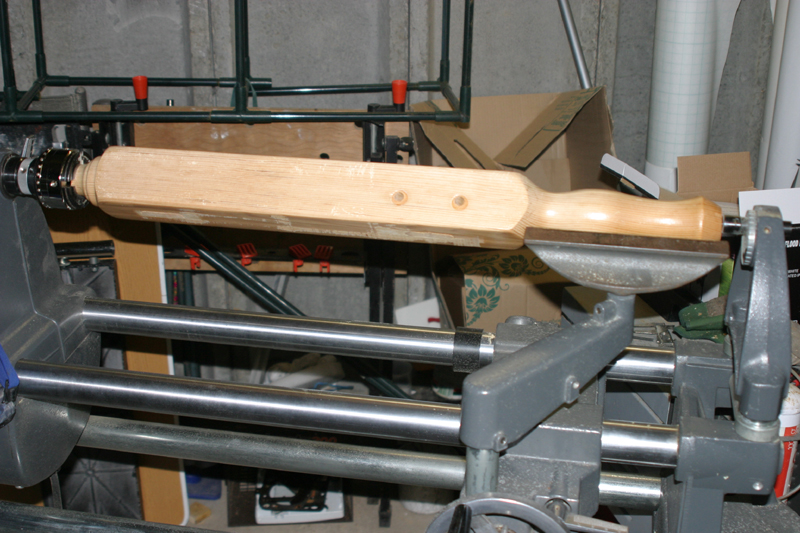

So before I could start on the real build I realized that I would have to glue up some of the planks to achieve thick enough components - rockers & side panels in particular. I also had to turn the old chunky bed legs off center to form the arm rest supports in preparation for the more elegant chair legs:
[ATTACH]21079[/ATTACH]
Before & after - the freshly turned pair will form the front legs & arm rest support:
[ATTACH]21080[/ATTACH]

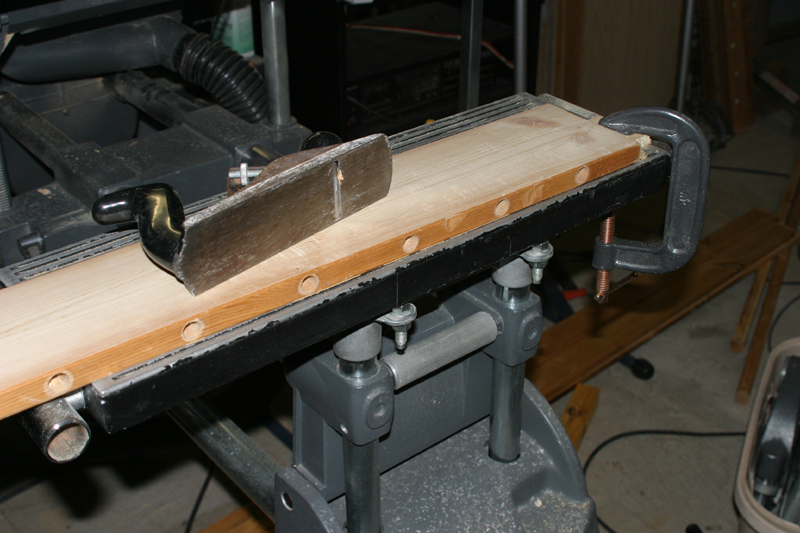

So I started hand planing:
[ATTACH]21087[/ATTACH]

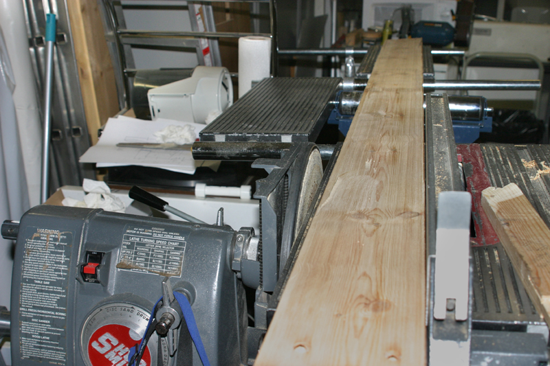

& then resorted to a power planer just to get down to the wood. Then I was able to use the SS disc to flatten the boards:
[ATTACH]21088[/ATTACH]

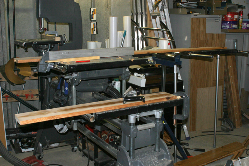

I was thankful for the Shopsmith's versatile table system - I only have the basic 510 kit but I haven't been stuck yet. Although I have added a single roller stand.
[ATTACH]21086[/ATTACH]

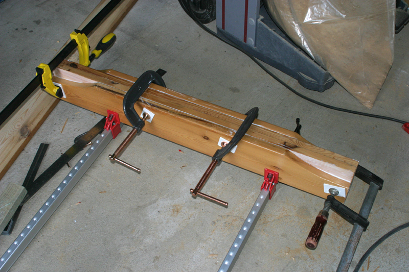

My limited collection of clamps means that I can only glue 1 assembly at a time however I've been able to glue the 2 matching parts at the same time - these will be the rockers:
[ATTACH]21089[/ATTACH]

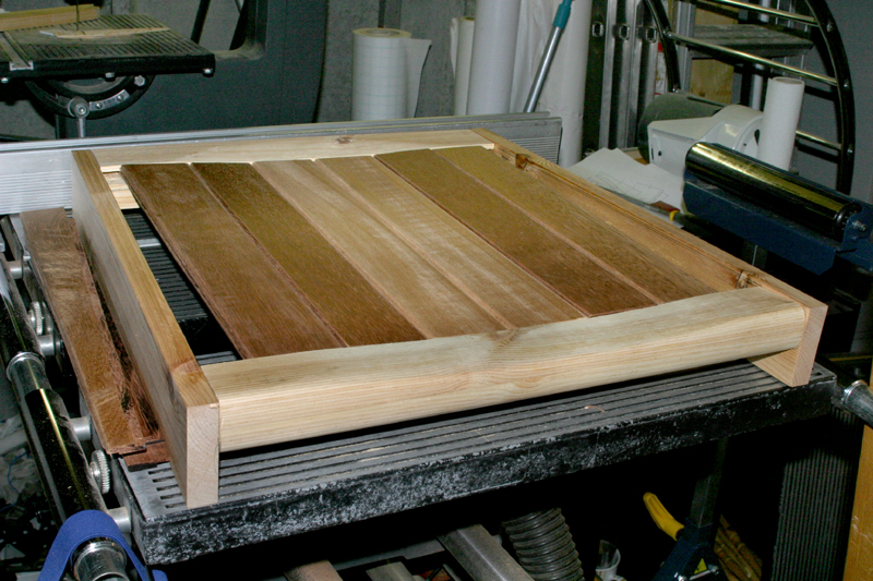

Oil & grease free once more, I have now got the seat assembly well under way:

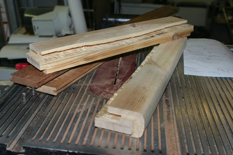

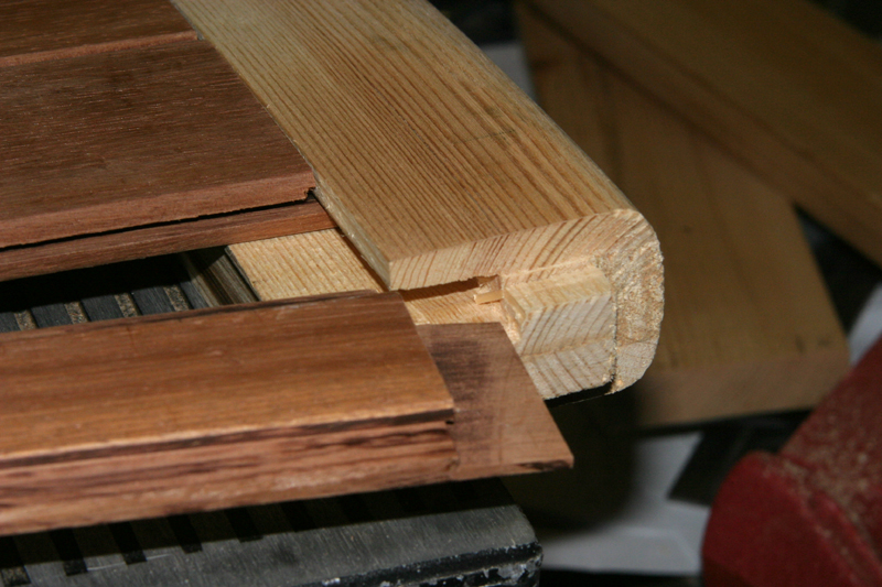

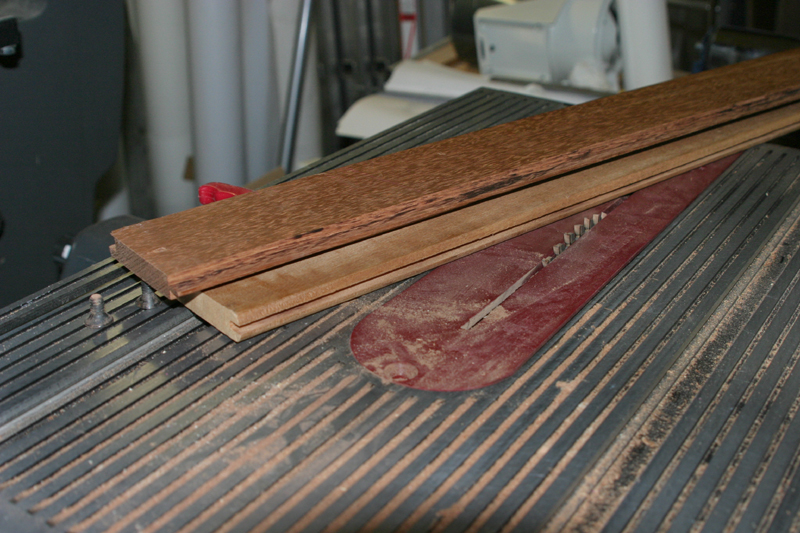

The seat slats are tongue & grooved to allow movement whilst spreading the load. The Shopsmith was great for this but there are a few scorch marks on the wood - I'm wondering if the blade is as sharp as it should be?:
[ATTACH]21267[/ATTACH]
Health & Safety Disclaimer: Don't worry about the insert screws - I'd just taken them out to change the insert & then decided I should grab a couple of pics.

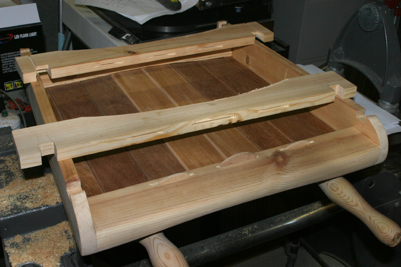

Below are the front & rear seat frame parts. Comparison with the Sketch-up drawing shows that the physical seat is shaped with a curve in the middle - I couldn't work out how to do that in Sketch-up. I'm thinking that may be more comfortable and the same will apply to the seat back as well. The curve resulted in a very rough routing job - I'm just not set up for routing curves so a lot of chiseling & sanding ensued :o The lip was cut after the routing to give the seat slats a solid base. That slot is there for the seat slats to sit in unglued so they can flex a little when sat on
[ATTACH]21264[/ATTACH]

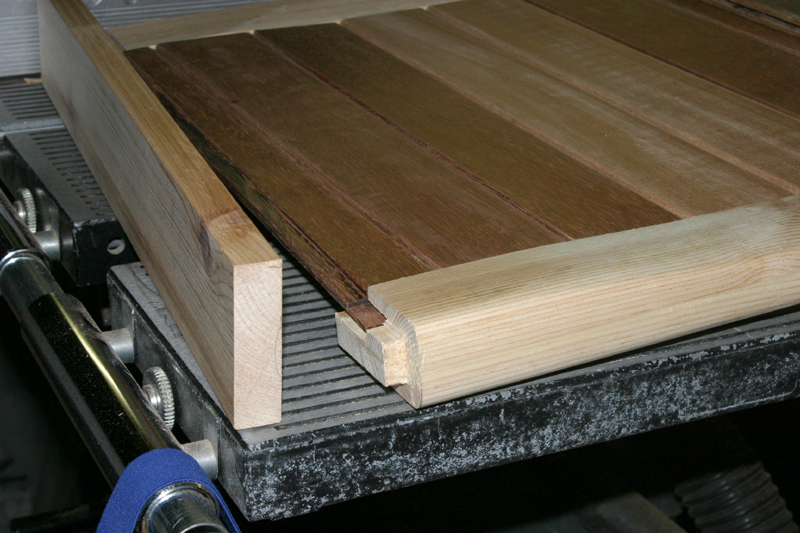

The upper half of the slat is cut away to slide into the front & rear frames to leave the top surface flush - I do intend to finish sand the seat panel to remove any bumps!
[ATTACH]21266[/ATTACH]
This shows the overall idea; the side panel will have a nice straight slot routed into it to accommodate the tongue on the outer slat ( I can do straight!!); same on the other side.
[ATTACH]21265[/ATTACH]

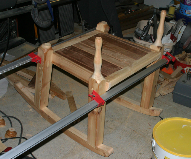

I've got the seat part glued up & I'm quite happy with that - front & rear crossmembers gave me a chance to use my biscuit jointer for the first time. I bought it because it was on special offer at a local store months ago & I've been itching to use it ever since :D The middle one was the first test piece & it went a little deep - hence the bigger biscuit :o
[ATTACH]21306[/ATTACH]

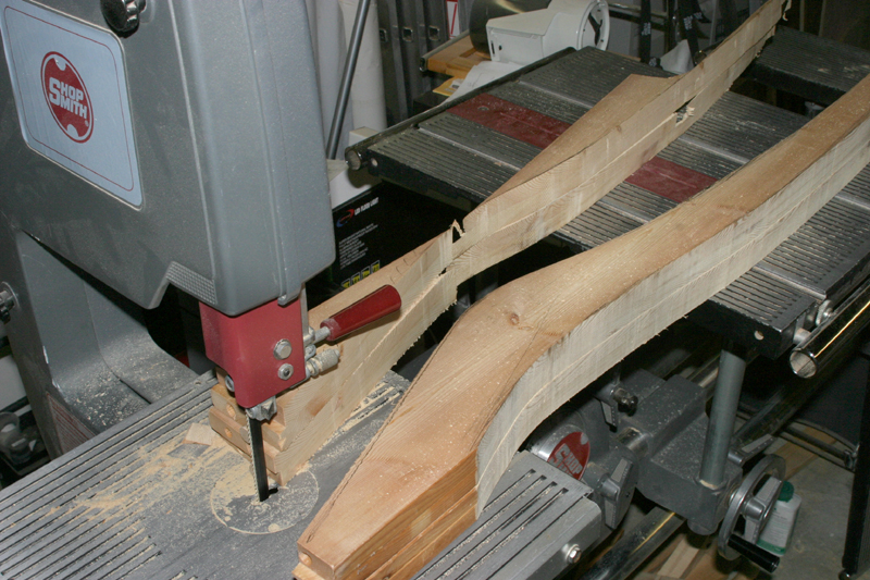

So with the seat ready it's time to move onto the rocker cutting. I used a hot melt glue gun to stick both rocker blanks together to ensure I had identical curves. The bandsaw made short work of that and it came out reasonably well considering it was guided by hand. It's a bit late after the event but if anyone has an accurate method for cutting totally smooth curves I'd like to hear. :o A fair amount of sanding followed and I'm now happy with those.
[ATTACH]21307[/ATTACH]

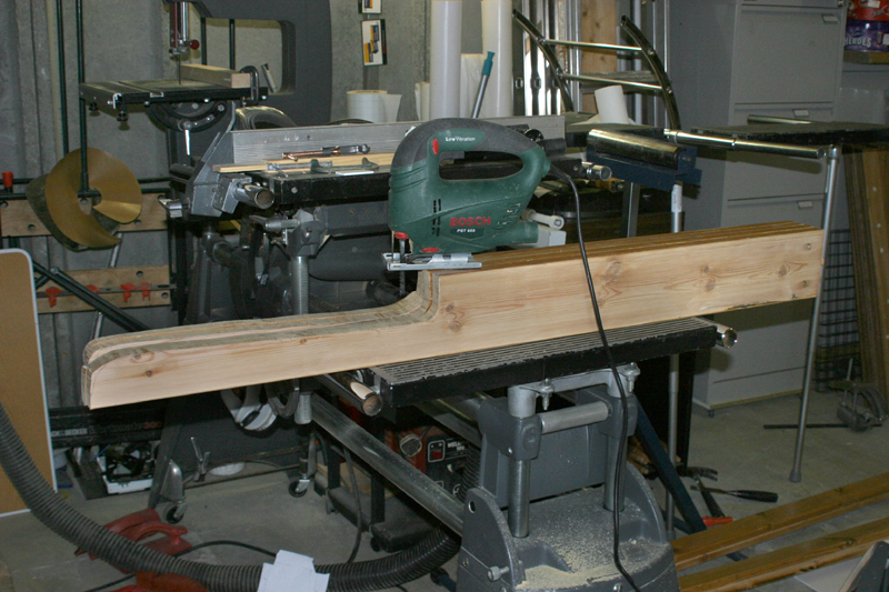

The other shaped cut is the side panel to form the frame of the seat back. Again there are 2 of these so the hot melt glue was used again. I double checked all my angles to make sure the cut would be spot on:
[ATTACH]21308[/ATTACH]

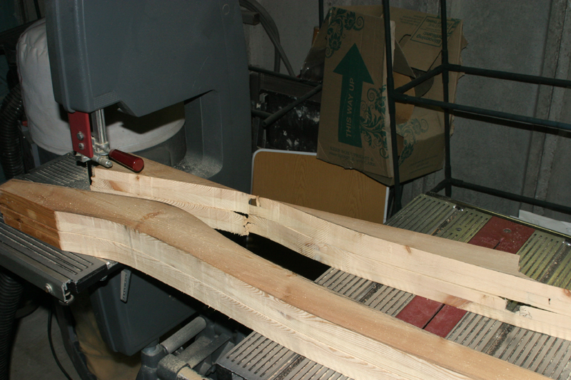

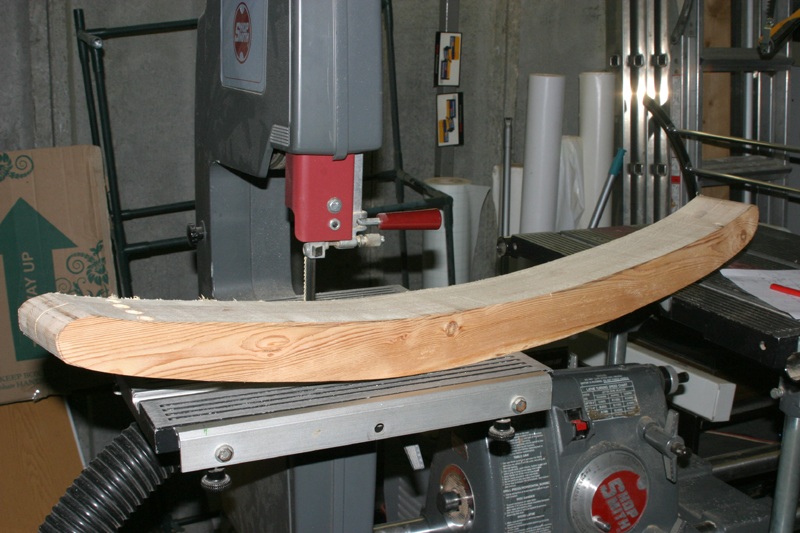

Then it was back to the bandsaw and another satisfactory cut. The freehand cut I had done with the jig saw back in part 2 turned out just right (more by good fortune than skill!) - the off-cut shows how tight it was to the edge - the spaces are where the blade just shaved the part.
[ATTACH]21304[/ATTACH]
I'm pleased with the perfect joint I got from gluing the 2 planks together to form the rockers & the side panels; there are no voids so all the effort I put in to flatten them paid off. :D
[ATTACH]21305[/ATTACH]

Only suggestion I have about reducing saw marks is to use a smaller blade which will greatly reduce your feed rate. For a very small blade, it's taking off a lot of wood, so if you have the patience, it will show very small cuts and you will still have to sand. Drum sanders for the SS mounted to a drill chuck will give excellent results.

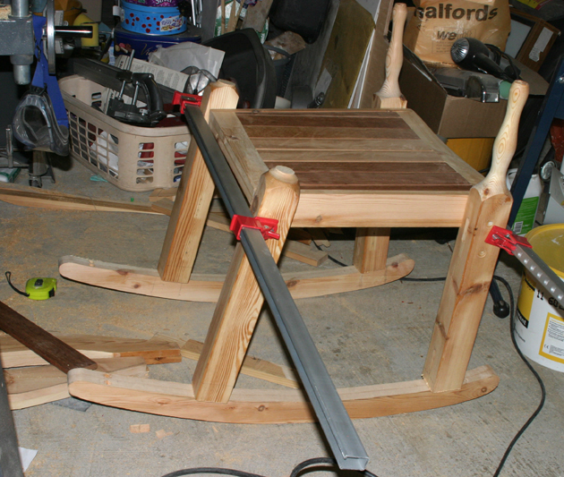

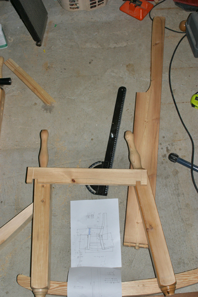

Well, tonight I got the bases of the 4 legs cut to the angles needed for them to join the rockers, plus the tops of the legs cut to support the seat. I decided that I would have to clamp it all together to see how it would sit; I couldn't work out the weight distribution from my drawings - the rocker sat perfectly in those no matter how I varied the design.
So I clamped the legs to the seat & perched that assembly on the rockers - and its not sitting right at all :(:
[ATTACH]21344[/ATTACH]
The whole assembly is leaning forward too much & the seat is almost tipping the occupant out the front:
[ATTACH]21345[/ATTACH]
Anyway, despite that, it looked so tempting that I just had to sit on it. :eek: It didn't collapse which has filled me full of hope for a reasonably successful outcome. But first I'll have to get those leg to rocker angles right :rolleyes:

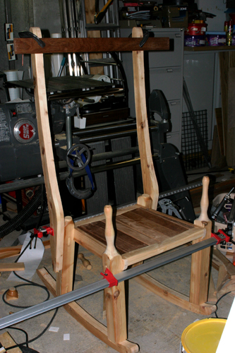

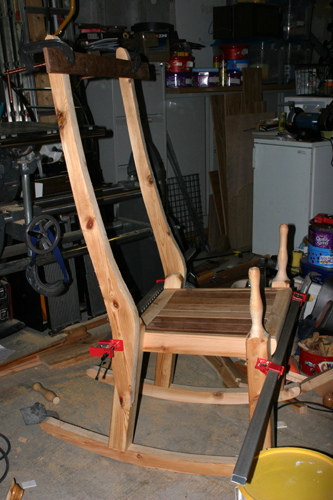

I then decided to attach the sides of the back - not where they will actually be left to right (they'll slot into the legs) but more to see what the profile will look like.
[ATTACH]21347[/ATTACH]
There are certainly changes to be made - the back is too tall & I think I need to tip the seat back a bit, possibly by shortening the back legs. There is a bit of experimentation to be done before I join those sides to the back legs. Then I'll clamp it all together again & decide on the shaping that is to be done on the legs & sides - right now it's very chunky. I want it to "flow" a bit.
[ATTACH]21346[/ATTACH]
So I have the weekend ahead of me and, unless I get sidetracked with life going on around me, I hope to make some real progress. You can be sure I'll post the results here. :)
