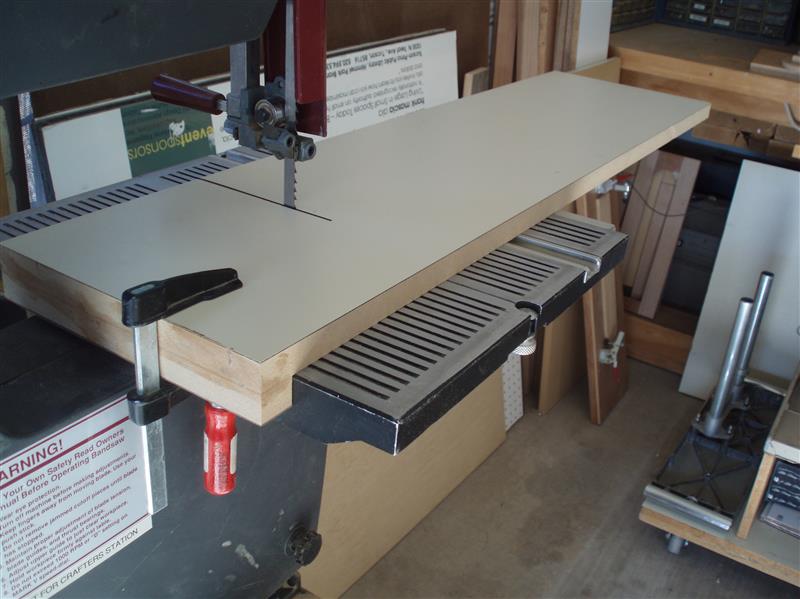

This is my solution to your task of cutting circles.
Don't look for the center pin, there isn't one yet. I just remade this table extension and have not yet cut any circles (thus no pivot point). This works up to 23 1/2" (limited only by the length of the item being cut.
I do NOT have the right blade installed on the band saw either. I would use nothing larger than a 1/4" to cut a circle the size of a typical stool (12").
[ATTACH]21117[/ATTACH]
CAUTION: When cutting larger circles it becomes necessary to support the outer end of the jig table. The telescopic leg works well for this.

dusty wrote:This is my solution to your task of cutting circles.
Don't look for the center pin, there isn't yet. I just remade this table extension and have not yet cut any circles (thus no pivot point). This works up to 23 1/2" (limited only by the length of the item being cut.

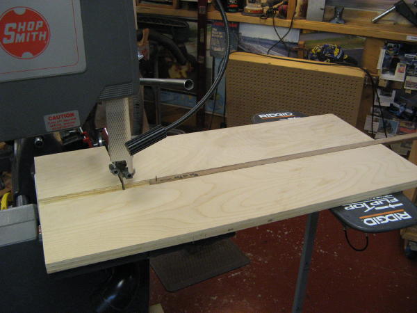

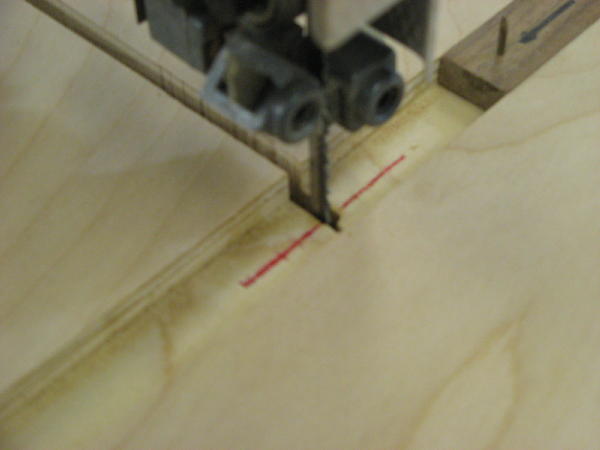

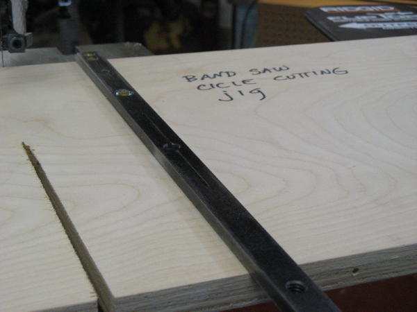

Here's my unit, no idea where the plans came from, I'm guessing just from memory of several units. I support one end with one of those units from HD I think. Through a couple trials I determined that I need that red line to line up with the teeth and then I get a decent circle. On the back I used an old miter gauge bar. Not shown are the spring clamps: 1. holding the jig to the bandsaw table so the whole thing doesn't walk away when it's running and 2. one to hold the adjustable centering pin in place. I don't use this often, but it's worked just fine
[ATTACH]21118[/ATTACH]
[ATTACH]21119[/ATTACH]
Underside
[ATTACH]21120[/ATTACH]

berry wrote:Here's my unit, no idea where the plans came from, I'm guessing just from memory of several units. I support one end with one of those units from HD I think. Through a couple trials I determined that I need that red line to line up with the teeth and then I get a decent circle. On the back I used an old miter gauge bar. Not shown are the spring clamps: 1. holding the jig to the bandsaw table so the whole thing doesn't walk away when it's running and 2. one to hold the adjustable centering pin in place. I don't use this often, but it's worked just fine
Underside
