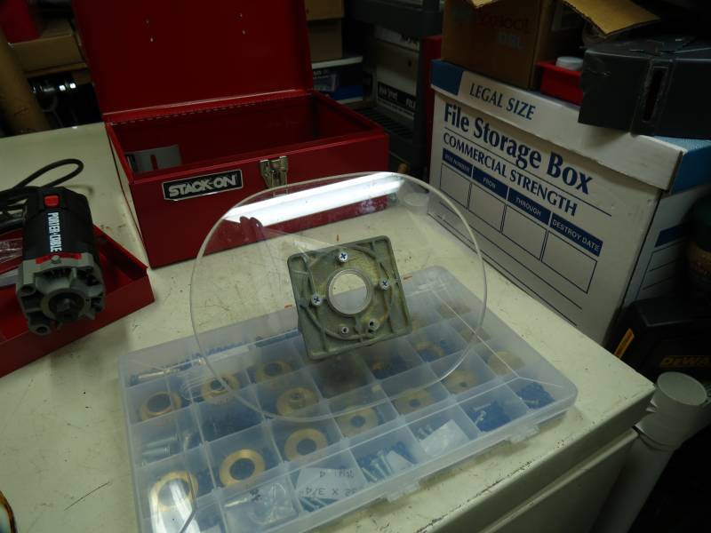

I had a few moments at the end of my workshop day so I shot some pictures for those who might be interested.
Background, the PC trim router has a small base which works great for doing what it was designed to do, but when I was doing some work the base was just too small. Routing out areas can leave you with no place left for the router to sit, expanding the sub base will fix that. You can think about this as the same thing you might do if you were going to table mount the router and needed a plate to mount it to.
I had some material so this is what I built.
[ATTACH]21134[/ATTACH]
I believe this is 3/8" in thick and is quite rigid. I opted for this shape due to what I was working on and has worked for other projects just as well, yea it might look a little odd but it works.
Here you can see the mounting screws that attach the sub base.

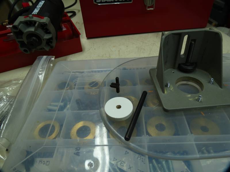

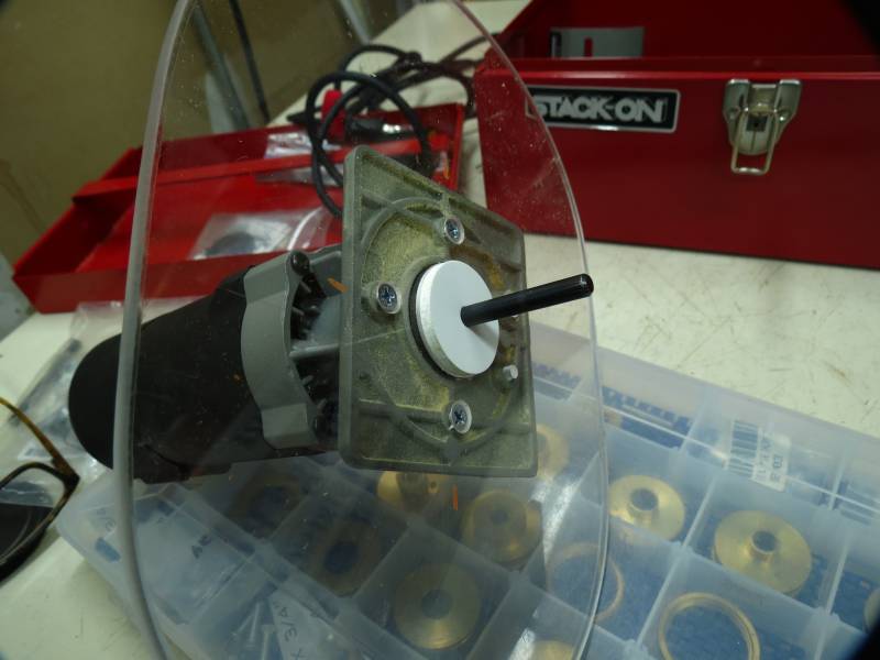

[ATTACH]21135[/ATTACH]
In this picture you can see the parts that a kit would include. You have a drill rod and insert with matching hole. Please note that this hole is the one that gets drilled first. Then you have pointed threaded screws that fit the router base. They are used to find the location of the hole so you can get them in the right place. The insert and drill rod provide the starting point and you work out from there.
This photo shows the concept of how this all works. Keep in mind any time the sub base is removed you re-assemble it using the same process. The locating datum is always the router shaft.

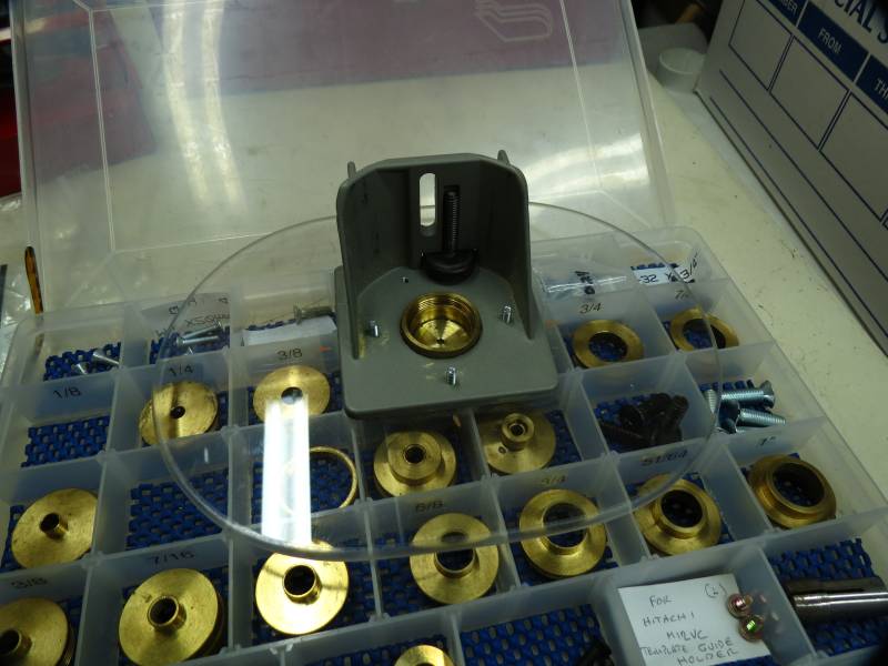

[ATTACH]21136[/ATTACH]
This shows an insert installed. The one installed is 1/8" and is recessed in a counter bore so the sub-base can slide over the material without any interference.

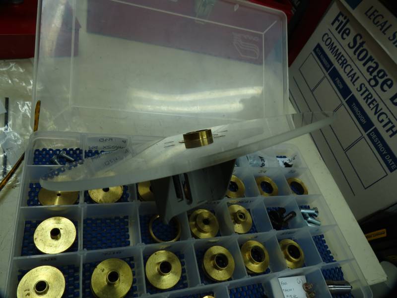

[ATTACH]21137[/ATTACH]
A nut holds the insert in place as shown here.
