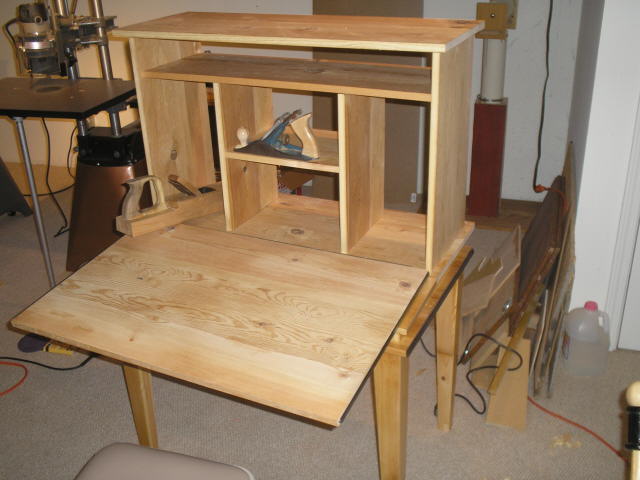

I wasn't sure I understood the exact question you had.... so my info here may not hit what you're after.
Here's a pine 'secretary' I made from old pine boards from a dumpster. Things I can note are:
- All the long-grain glue-joints were straightforward and durable. I never much thought about that direction of grain having expansion/contraction differences.
- The very large glued-up panels such as the writing surface, I knew would want to bow. So I've got some thin steel rails inset into them, serving as "breadboard ends". (Steel rails re-purposed from that same dumpster.)
- Where my shelves are installed, each end of each shelf has 3 dowels holding it in place. It's all held up well seasonally for 3 years now. If you're making something similar, it ought to do fine I'd think
[ATTACH]21227[/ATTACH]
- Secretary with Planes.jpg (46.8 KiB) Viewed 4238 times

Thanks, Chris. The construction of your secretary isn't too different from what I'm doing. Here's a pic of the doll house laying on its back (the right angle clamps are on the bottom of the house - the angled cuts will be the top).
Nothing is glued, screwed, or attached in any way. They're just standing up.
