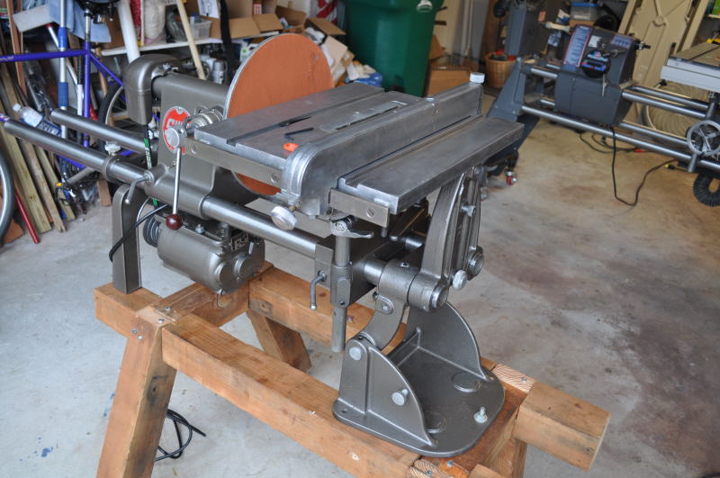

I have mostly stand alone tools - TS/Lathe,SS planer, jointer, miter saw, BS (old general CA). I picked up a old Mark 5 in fair condition about a year ago and made it into a mini set up as a dedicated disk sander. I love the big table and variable speed.

I would enjoy seeing a few pictures of your mini dedicated disk sander, if possible. I really could use something like that. Thanks!fordtrax wrote:I picked up a old Mark 5 in fair condition about a year ago and made it into a mini set up as a dedicated disk sander. I love the big table and variable speed.

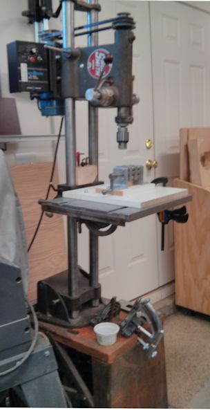

I purchased a used 10ER in April and have been assembling a motor, cleaning and lubricating parts and over the past week shortened the stand to create my dedicated 10ER drill press. I have done a bit of drilling and am totally impressed with how well it functions. I did add a shelf to the bottom of the stand upon which I have assembled a number of extremely heavy items I am labeling "Ballast" thus have no noticeable desire to tilt. The jig on the table is a pen drilling jig I adapted yesterday from the Mark 5. I tend to agree with this being a superior option for dedicated drilling. Jim

I thought I read somewhere here that folks were having trouble with mortising with the MV, where the table was flexing with all the downward pressure - I presume such a problem would be greatly reduced with a 10ER, as there's not much to flex in that design.
