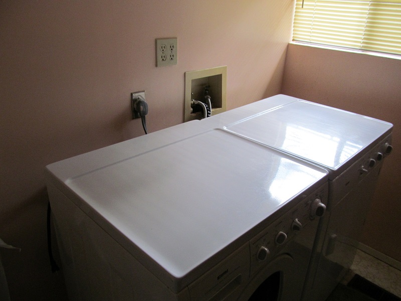

[ATTACH]22037[/ATTACH]

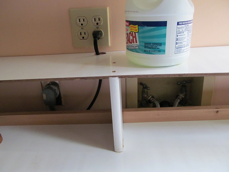

Picture 1: W/D set and utilities on wall. There was a line between the plumbing services, 240 V outlet, and the 120 outlets which determined the height of the shelf above the W/D.
The concern was how can I build something that will adjust to a gap which may change when the set moves or the width of the gap requirements change. A cleat on the bottom of the shelf would not be easy to change. The ability to adjust the mechanism seemed to be critical because of the possibility that the shelf could slide down the wall and dump the contents into the gap. A pair of eccentrics was selected to provide push against the back edge of thew/d set because they could be adjusted independently. The eccentrics are used to adjust the position of the shelf, keep it level, and touching the sweet spot between the utilities on the wall. The eccentrics were used because they were simpler than a french cleat attached to the lower edge of the upper shelf.
Clearance for the hoses and cords was achieved by offsetting the back edge of the lower shelf by 3 ½ inches. The offset allowed the supply hoses and drain hose to run under the top shelf and clearance for the 240 V pigtail. The same width was used for both shelves, allowing the lower shelf to extend 3 ½ inches beyond the vertical shelf supports. The upper shelf was flush with front edge of the shelf and the back edge of the upper shelf sets against the wall.

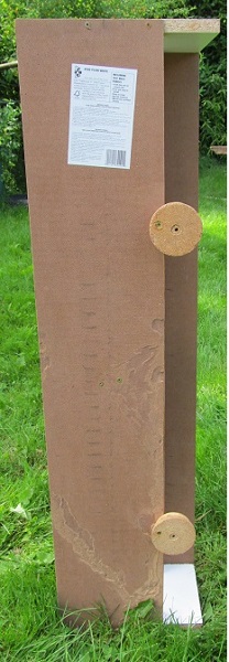

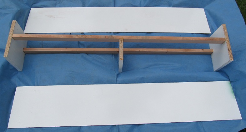

Picture 2 : Assembled shelf supports (fronts) and rails and unattached shelves:
The shelf supports on the ends were 8” (H) x 9“ (L) x 3/4” (W) melamine covered particle board. The center shelf support was 8” (H) x 5 ½ “ (L) x 3/4” (W) melamine covered shelf stock, rounded leading vertical edge. The shelves were 9” (W) x 47” (L) x 1/8” (T) melamine sheet. The 9“ width was influenced by the gap and the damaged corners of the originally 12” wide melamine sheet offcuts.

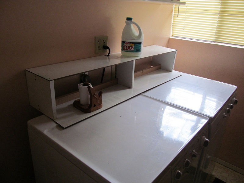

Picture 5: Shelves on W/D showing access to faucets, upper shelf leading edge reinforcement with 2 “ strip of melamine and lower shelf rail as backstop.
The eccentrics appear to hold the shelf in place and so far have not exhibited a tendency to loosen and dump the shelf contents behind the W/D set. The eccentrics had a diameter of 3 1/2” x 1 1/2” (T) and would be useful for gaps of 3 ½ + 2 ¾ = 6 1/4”
