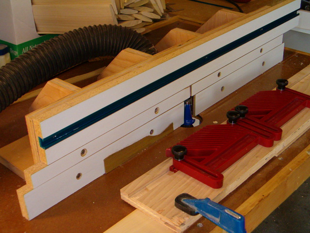

Hi all, I have been given a shopsmith mark V router table and router fence, I am having issues trying to figure out a way to easily offset the outfeed fence from the infeed whilst keeping everything level, the fence arrived with a single bit of mdf attached to each of the of the 2 pieces of aluminium that make up the shopsmith fence, I'm hoping that someone might have some ideas on how I could adapt the fence to make it a bit easier for a novice to use?
At the moment, all I can really think of is shimming the outfeed fence and also adding a 2nd set of sacrificial front faces so that I can treat it like a split fence to close up the gap when necessary.

it is essentially 2 bits of angled ali with slots, I've had a little think about it, I need to go and double check holes/slots etc. but perhaps using a flat base piece going across the 2 fences would allow offset adjustment, have the infeed so that it's fixed in some way with the outfeed fence still able to move relatively freely, I can then add sacrificial faces to the front of the fence plates that can act as a split fence. I could possibly even add a block with a bolt through it and rig up a micro adjustment thing for the outfeed fence.

Here are some photos:

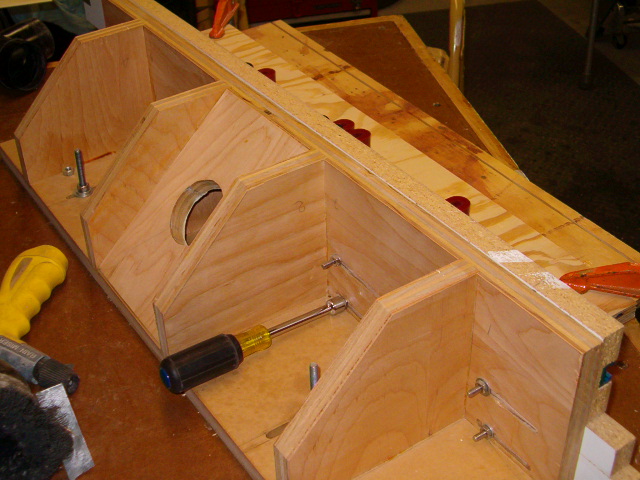

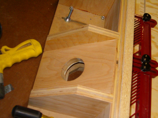

If you build a fence it should have sliding faces to close around a router bit as well as a dust collecter box. This photo was taken when on another table, but it now has been adapted to the Shopsmith table. It only took two slots on the base to fit the new table.
