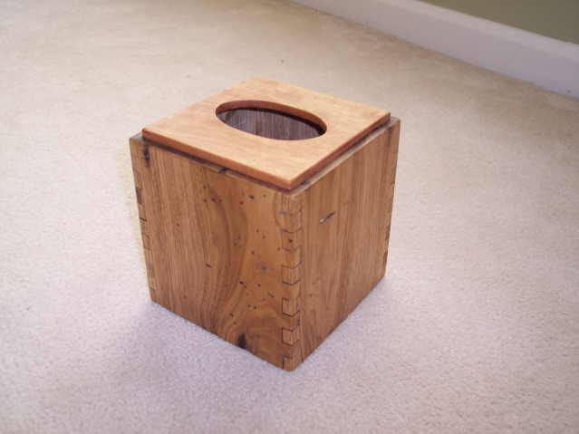

charlese wrote:Most often box joints are made into end grain. I've found this to be the only practicable way.
I did one the other way.... had to re-glue a few fingers. But in the end it was easy to plane!
[ATTACH]22094[/ATTACH]
Butternut Tissue Box.jpg (21.83 KiB) Viewed 4193 times
Chris
jere wrote:Yeah I think I see your point, I will try again with the wood turned the other way. At least I got the spacing close, I am starting to think I need a smaller diameter of all thread. That might give me some more fine tuning.
Yep! looks like your fingers are nice and tight! They look good!
Your frustration using screws to make adjustments was mine also. That's why my present box joint jig is adjusted with hammer taps. This is a tip I got from an old TV show about routers. Works fine with a saw too!
IMO - screws are fine for 1/4" box joints that are up to 5 or 6 inches long, but in order to get joints of up to 12" or so, you need hammer taps.
