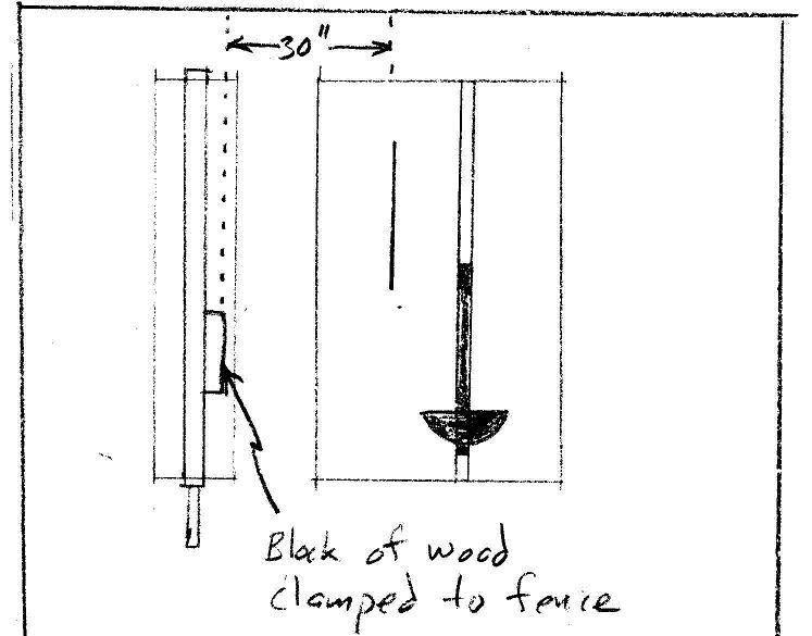

While your near-future upgrade to a 520 will be an enjoyable addition, you can cut your 30" pieces of 1"X6"X8' safely and repeatably:
By clamping a block of wood to your Extension Table mounted Fence, and using your pistol grip miter gauge, it should be no-sweat.
[ATTACH]924[/ATTACH]
(please excuse the poor excuse of art work) If you use your Extension Table on the left side of the blade, your cut off piece will be supported and keeping your pistol grip clamped tight on the board until you pass the blade will prevent the long part from dropping too.
If you prefer to clamp the miter gauge to the 30" piece, you would use the Extension table on the right side and you could rig some kind of temporary support to prevent the cut-off piece from dropping.
Either way, make sure that the block of wood stops short of the saw blade (so you won't bind the board).

I was originally thinking along similar lines as you've described - clamp a stop block to my side table. My 500 only has one side extension table, so I moved it to the left side and clamped a block of wood to that, and then positioned the headstock/main table to provide the 30" width to the stop. However, this left no support on the right side of the main table, and the 8' 1x6 workpiece hung way too heavily on the right side. I couldn't slide the workpiece with the miter without the workpiece rotating or tilting/binding the miter in its channel. The larger main table and the two extension tables was the main reason I decided to jump to the 520.
I really like your idea of using a block of wood clamped to the fence! This will make fine adjustments easier, and is better than just clamping a stop block to the side table. Thank you!!

.......... this left no support on the right side of the main table, and the 8' 1x6 workpiece hung way too heavily on the right side. I couldn't slide the workpiece with the miter without the workpiece rotating or tilting/binding the miter in its channel...........
.......................I also need to rip 24 2x4x8 boards straight in half, although I haven't decided if I'll use the Shopsmith for that, or lay them out on the garage floor (raised and supported on 2x4 scraps), align the ends and clamp together in batches, and buzz a circular saw straight across them..............Chris
You might be able to create a temporary support table next to the Mark V? Sawhorses with a stack of some of those 24 2"X4" 's would work.
