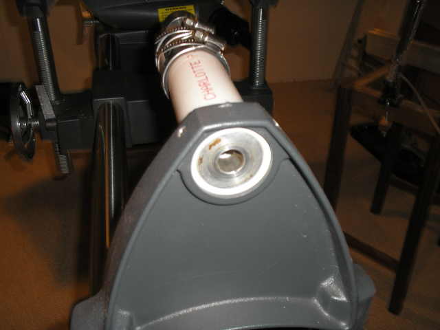

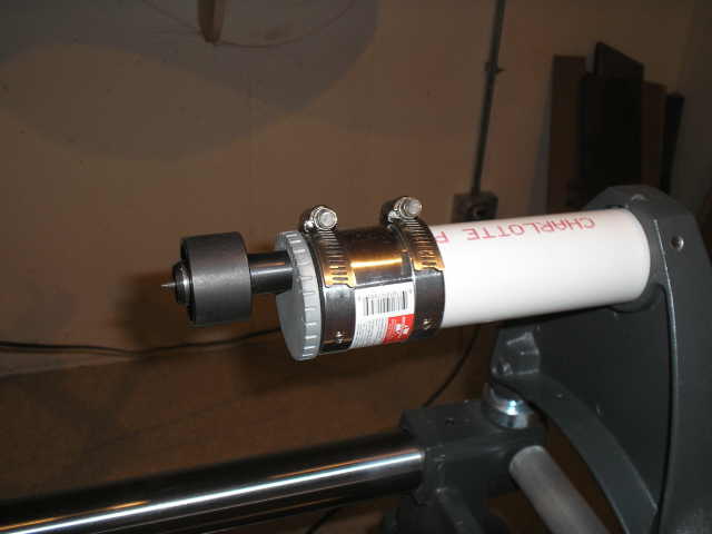

Hello,
Having a 510 with the wide stance on the worktable-lift tubes, it seems the location of the lift for the Lathe Tool Rest is not optimum for a very short workpiece such as a pen. I saw elsewhere on the forum that some folks had procured a #2 Morse Taper extender to get the pen-blanks/mandrel farther toward the headstock and allow better positioning of the tool rest.
I rattled around and found some PVC tubing and fittings in the basement which I got to do the trick for me. The "stiffening" piece inside the end of the PVC that's clamped in the tailstock-side is right off the end of a discarded Quill. (The shiny part right before the tapered end of the shaft.) I just 'turned' the inside of the PVC with a pocket knife to get a nice fit.
This got me to the best (6-inch) tool-rest postion I've yet used for turning my pens, and I had very easy turning as a result.
Would be interested in anyone else's favorite pen-turning ideas, too!
Best Regards,
Best Regards,
- Tailstock extension.jpg (20.78 KiB) Viewed 18408 times
- Stiffened with Insert.jpg (23.27 KiB) Viewed 18286 times
Chris

I posted pictures elsewhere on the forum but I use a #2 Morse taper to #2 Morse taper extender and two Shopsmith live center extenders to get the same effect. I like Steel vs. PVC. PVC is OK for turning Pens but I am turning large bowls and wanted the live center very strong.

Paul: Good comments; I may have seen your pictures some time back. I agree the PVC extension is suited for light-duty pen turning but nothing of appreciable mass, where steel would be better.
