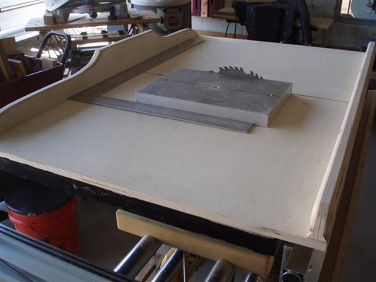

I assume that this sled is going to be used on your Shopsmith. If so, you do not want a sled with a "permanently" attached fence.
The sled, by its' design, is positioned on the main table by its' miter bar(s). While the miter tracks are in the main table and the main table is adjustable (with respect to the blade), you do not want this to be your final adjustment. Unless you believe that you can precisely align the table to the blade, I believe you are going to want to tweek the fence.
[ATTACH]22845[/ATTACH]
I don't know just how accurate this sliding table fence is but it does the job for me. Yes, those a draftsman's triangle are my primary alignment tools for the sliding table.
Crosscut Sled (New) 201 (Custom).jpg (28.88 KiB) Viewed 3437 times
Not having seen the plans, I be making two assumptions.
The 90° 'fence' is as illustrated in Dusty's pix above.
A 45° 'fence' is added to allow cutting frame miters.
The 90° 'fence' absolutely needs to be adjustable(initially and possibly in the future).
The 45° 'fence' only has one 'critical angle at the 'point' which must be = to the angle desired for the frame 'corners'(typically 90° for rectangular frames). If that 'point' is slightly off relative to the blade, the two sides of the fence are 'complimentary' and will still add up to the desired corner angle. If the 45° fence is made from a single triangular shaped piece with the 90° point it could be easily made from a square piece cut accurately cutting the diagonal between opposing corners(ala Shipwright) . An inaccuracy of the two base angles will be realized in unequal sides of the two pieces(blade skew angle at the point[again]) but likely will be too small to be objectionable.
The 'fence' faces do need to be Flat. Adding sandpaper to a flat face would not introduce much error, and the non-slip feature would be the greater factor (IMHO).
Obviously perfect angles would be 'best'.
I apologize if my two assumptions are invalid, but this the way I 'see' it:).
