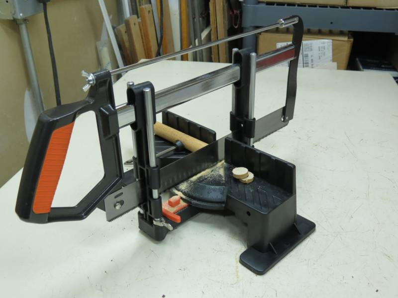

When I take to hand cutting dowels or other such items I go with this
[ATTACH]23141[/ATTACH]
I think I paid like $17 for it and it is small enough to store near by for occasional use. It does a pretty good job and can except various blades, the one shown is a 14 tpi, if you want to do metal they have a 24 and 32 tpi.
This looks and works a lot like the old Jorgensen miter box but this is much smaller with a lot of plastic parts. I'd say it is worth the price as long as you don't get carried away with what you do with it and forget the gorilla strength....
If I recall these came out in the mid 2000's or so and I think they still sell them but I haven't looked of late.
Another plus is that it has rubber feet so for small jobs you can just pick it up and set it some where with a flat surface and make your cuts. For larger jobs it has holes to screw it down.
Fixed stops at 90, 45, 36 (5 sides), 30, 22.5 and 15 degrees. All of which seem to work very well.
