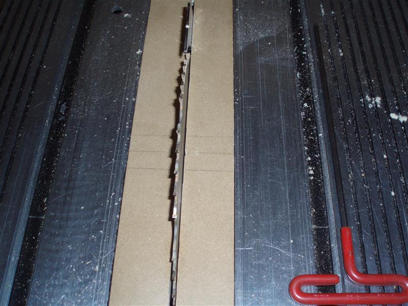

Table Insert. Order a Table Insert. Why do that? Make your own table inserts.
Well, maybe. You gotta have a table insert to make a table insert.
A ZCI is a valuable tool. Using one will give you a quick indication if table to blade alignment is out or if the arbor is not tight on the shaft or if you have failed to secure either the carriage or headstock lock.
Each time I reconfigure, I have a habit of turning the shaft with power off before I turn it on. This will tell you a lot about the relationship of the blade to the ZCI.
