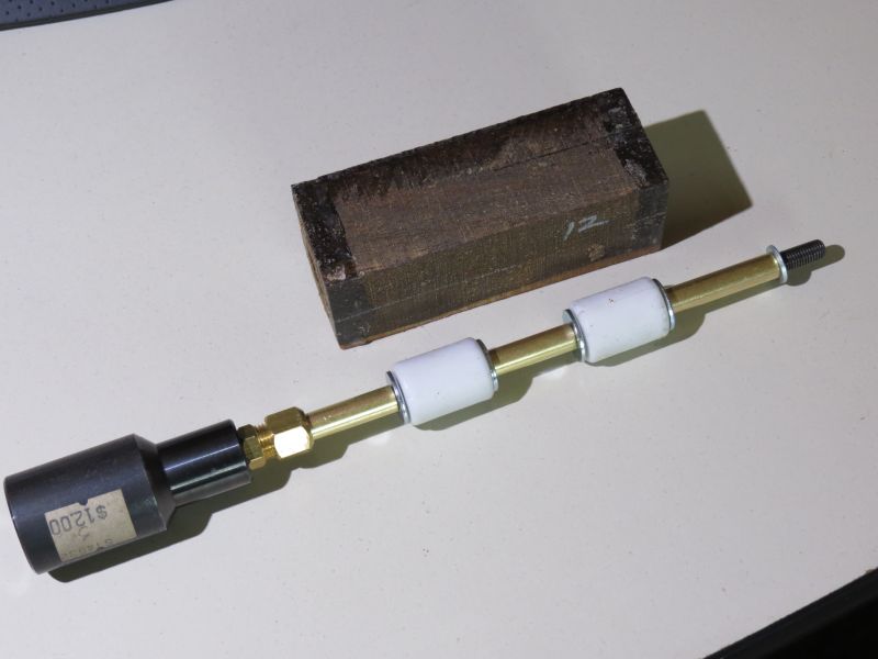

To start with I use a shopsmith 1/4" router chuck for holding a pen mandrel. The adapter kit I purchased will make use of the system I have. The series of pictures to follow show how this all comes together.

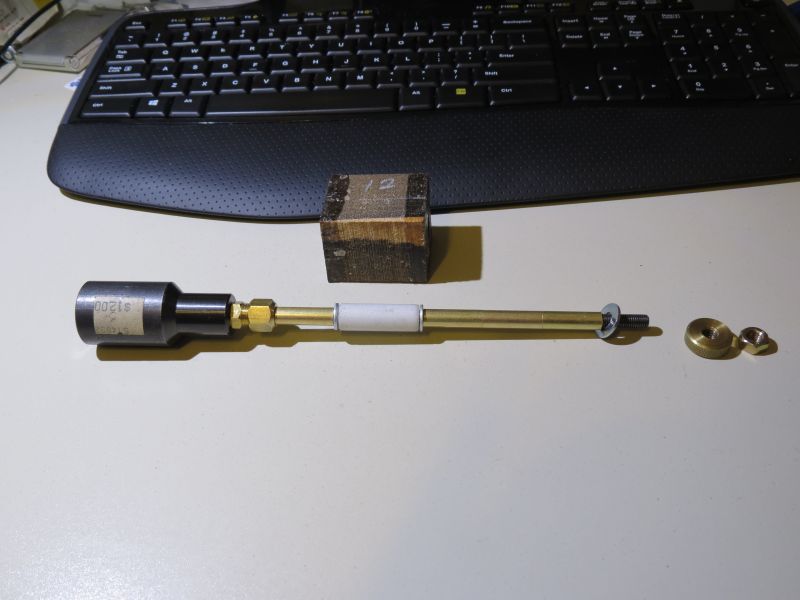

The kit comes with brass spacer tubes, so I started by sliding one of those on. For the 3/4" adapter I used one of the large washers next followed by one of the rubber bushings. Next was another large washer, brass spacer, large washer, rubber bushing and another large washer. I need another brass spacer to get to the threaded area of the mandrel and topped that off with yet another washer. The threaded nut is to large to pass through the wood blank so that was left off for now. Now with those pieces looking like this:
[ATTACH]24163[/ATTACH]
You can see why I used the spacer between the rubber bushings here
[ATTACH]24162[/ATTACH]

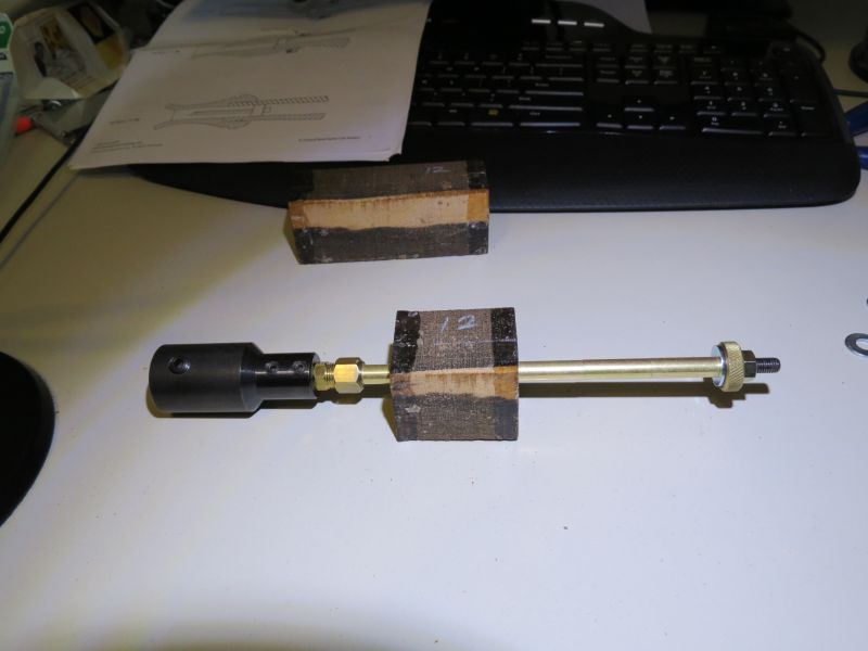

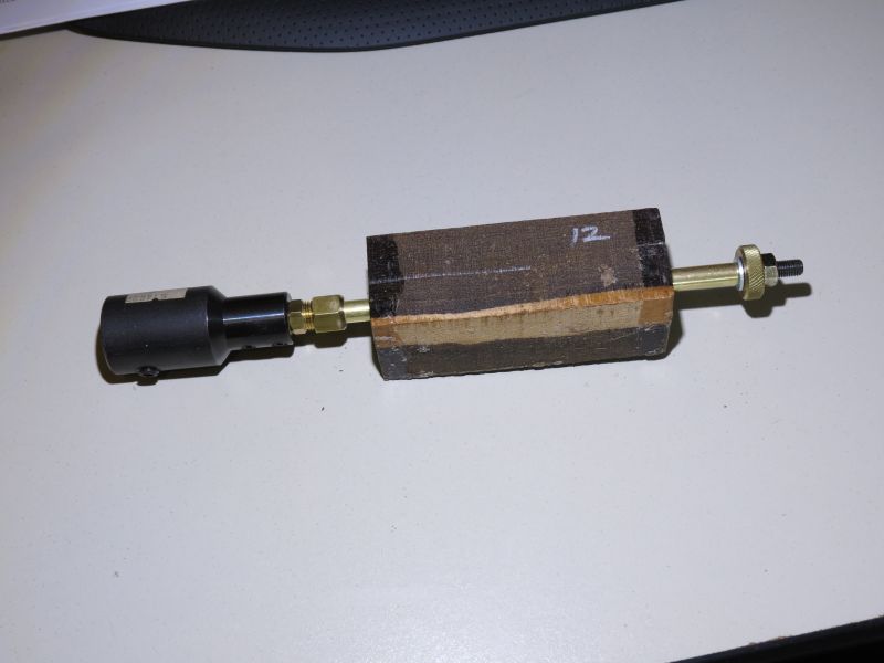

The wood blank is ready to slid over the rubber bushings and then the threaded nut is used to tighten. As the rubber bushings expand they grip everything together.
[ATTACH]24164[/ATTACH]
At this point the "tone chamber" (that is game call speak) is ready to be turned. Once it is shaped and sanded and finished on the outside you simple reverse the assembly order.

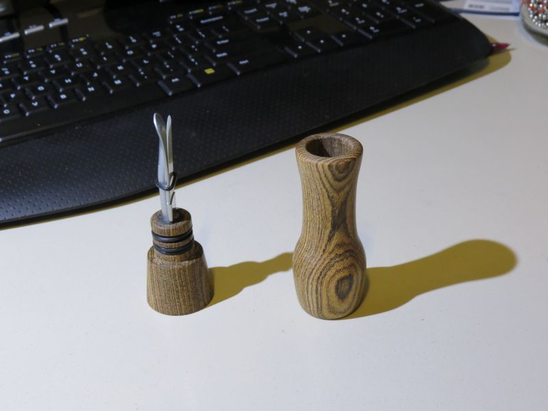

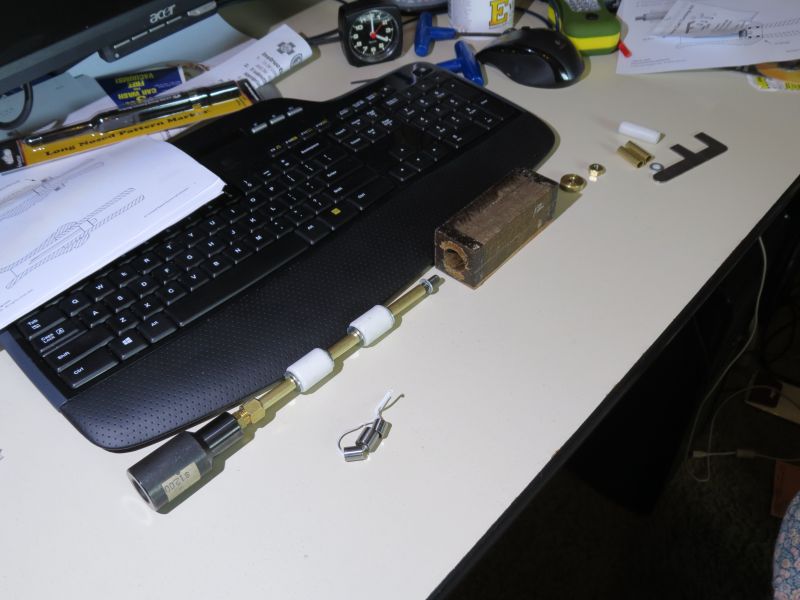

The "stopper" (also game call speak) needs to be mounted for tuning next. It is pretty much as you would expect.
[ATTACH]24166[/ATTACH]
[ATTACH]24165[/ATTACH]
Now I'll take all the bits and pieces and bag them for when I get to the point of doing the actual woodworking.

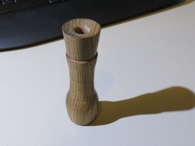

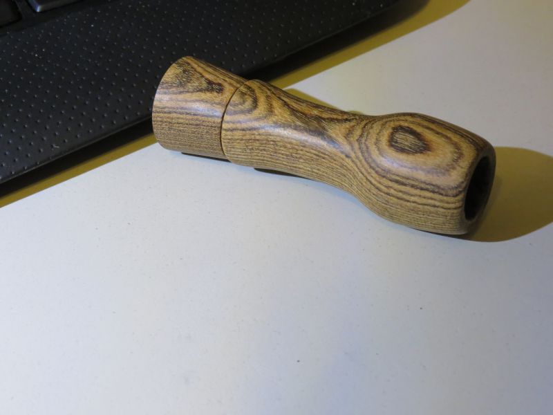

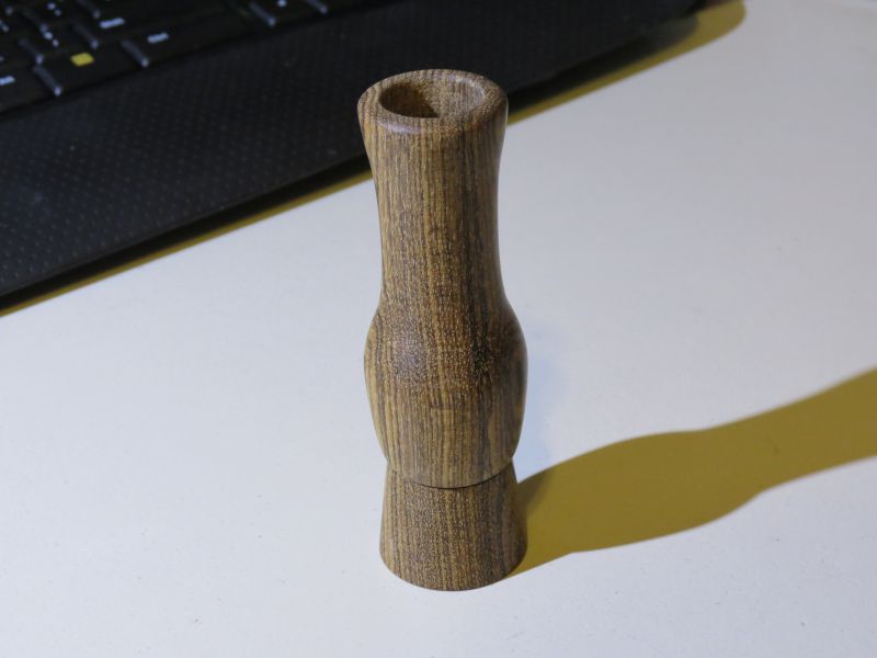

From the low number of visits to this thread (160) it looks like most folks didn't give a hoot about it. Still maybe someone actually had interest in the subject so I'll show you the very first and currently only owl call I have made.
I didn't shoot any how to pictures, again cause the lack or responses I didn't want to take the extra time to do so.
This is fresh off the lathe, sanded to 600 grit on the outside but no finish yet.
So here it is:
[ATTACH]24280[/ATTACH]
[ATTACH]24281[/ATTACH]
[ATTACH]24282[/ATTACH]
[ATTACH]24283[/ATTACH]
Now I have to figure out how to make it sound like an owl..... When I tried it, it sounded like a duck call, and an out of tune one at that.
