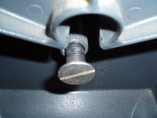

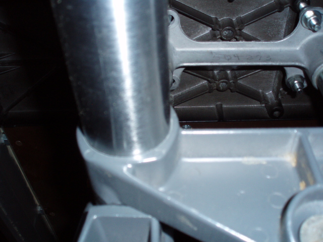

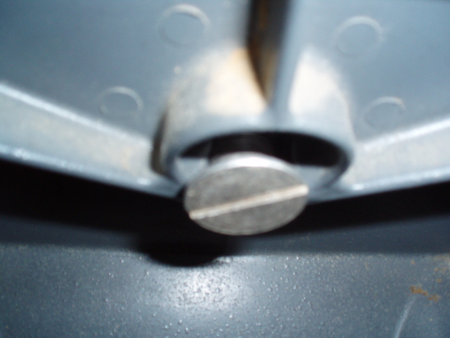

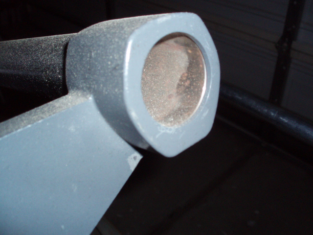

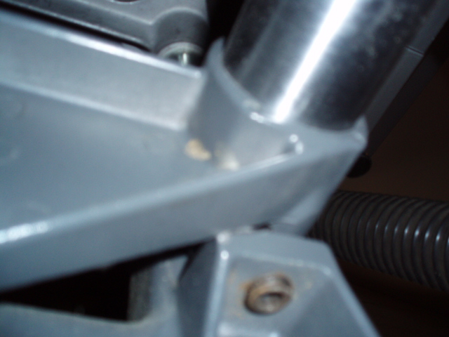

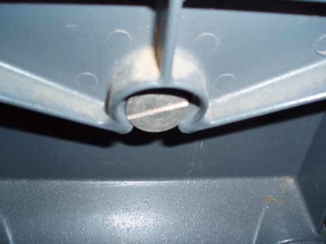

I am not certain that I understand your problem but if I assume that your way tubes are too long thus not allowing the Head Rest Lock mechanism to engage properly - I would first suggest that you make certail the way tubes are seated as deep as they will go in the Base Arm at one end and the Tie Bar at the other end.
I have taken a couple photos that I hope will help. I have more than I can post at one time so there will be a 2nd or 3rd post.
The first is the Tie Bar. Note that the way tubes are all the way inserted. The Tie Bar is secured to the way tubes by set screws.
If you put the Shopsmith in the drill press mode, you can loosen the set screws and take the tie bar off. Put the carriage and headstock all the way to the right end to do this.
- P3090004.JPG (136.71 KiB) Viewed 9641 times
- P3090005.JPG (145.71 KiB) Viewed 9641 times
- P3090009.JPG (133.42 KiB) Viewed 9641 times

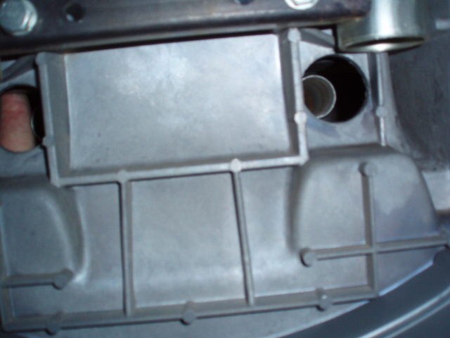

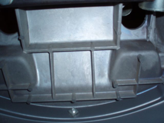

osx-addict,

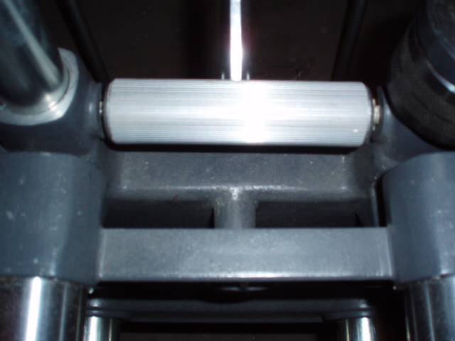

I am not certain that I understand your problem. Based on the statement that your way tubes are too long, thus not allowing the head rest lock to engage properly - I would guess that your way tubes are not fully seated in either the Base Arm or the Tie Bar.
I've taken a couple photos that might help. At least they might help us make sure we are talking about the right parts.
Tie Bar and Head Rest Lock

problem w/horizontal way tube lock
Some other photos of the tie bar, way tubes and head rest lock.
Head Rest Lock and Tie Bar

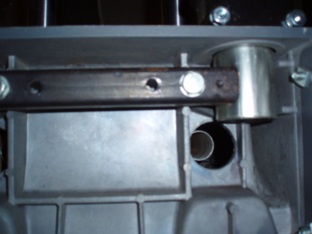

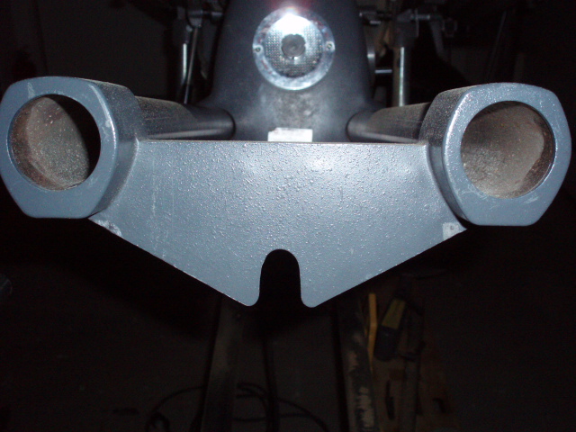

I've got a couple photos of the other end of the bench tubes (right side) but they aren't too revealing and may not be applicable to your problem at all.
One does show the bench tubes and the tube lock bar which is what holds the bench tubes into the base. If these (bench tubes) were not fully seated the span would be too long not too short.
The bench tubes are secured at both ends the same way.
- P3090001.JPG (139.52 KiB) Viewed 9725 times
- P3090002.JPG (139.31 KiB) Viewed 9725 times
- P3090003.JPG (138.71 KiB) Viewed 9767 times
