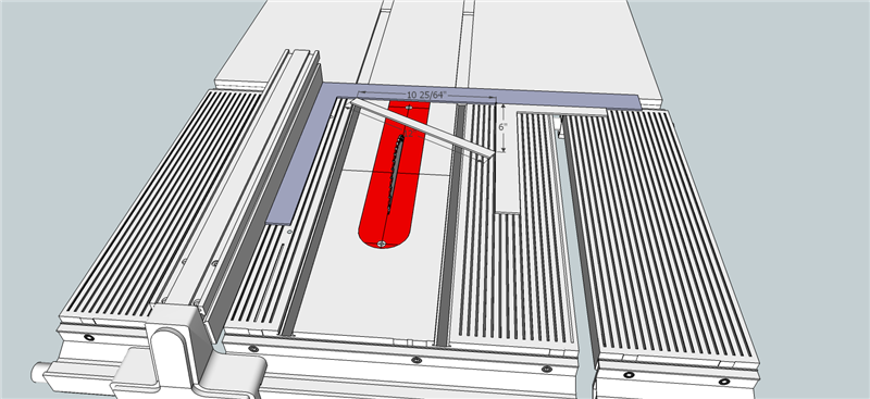

I was browsing through some old "Fine Woodworking" magazines the other day and came across an article that I found interesting.
With just the information that can be derived from the attached drawing, can you determine what the angle of a miter gauge would be if the face of the miter gauge was flush against the lower edge of the steel ruler.
[ATTACH]25164[/ATTACH]
- Main Table, Two Steel Squares and a Steel Ruler (Custom).png (190.68 KiB) Viewed 3801 times

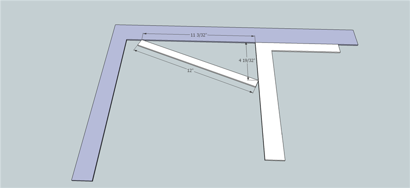

Maybe More Useful
[ATTACH]25165[/ATTACH]
This one may be more useful.
- Two Squares and a Ruler at 22.5 degrees (Custom).png (39.88 KiB) Viewed 3781 times
30:)dusty wrote:I was browsing through some old "Fine Woodworking" magazines the other day and came across an article that I found interesting.
The 10 25/64 is superflous.(except to insure the top right angle is 90);)
22.50800456:Ddusty wrote:[ATTACH]25165[/ATTACH]
[quote="JPG40504"]30:)
The 10 25/64 is superflous.(except to insure the top right angle is 90)]
Yes, mathematically it is superfluous but having that dimension helps during setup.

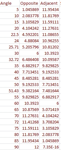

You guys could make this a lot easier by simply making the 12" ruler only 10" long. By doing that, the length of the vertical element (side opposite) can be read directly from the sine table.
MarkFive510
Ah, but the 12" ruler is more commonly found. Also the info Dusty is passing on does not refer to trig tables.BigSky wrote:You guys could make this a lot easier by simply making the 12" ruler only 10" long. By doing that, the length of the vertical element (side opposite) can be read directly from the sine table.![]()
I consider this to be a very useful methodology.
Any other 'magic' dimensions Dusty?
Oh and do not forget to multiply by 10!:D
The rest of us will multiply trig tables by 12.
[attach]25166[/attach]
Will add dimensions by 64th later.
- angles.jpg (88.3 KiB) Viewed 3739 times
