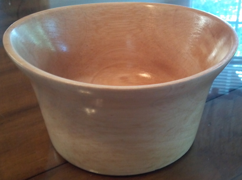

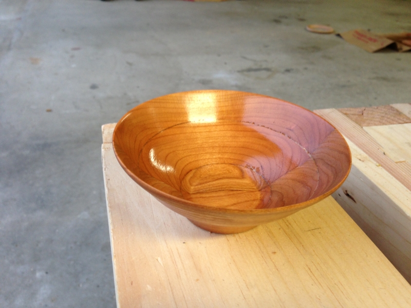

[ATTACH]25323[/ATTACH]
[ATTACH]25324[/ATTACH]
- 2013-12-18 07.10.01.jpg (288.98 KiB) Viewed 4421 times
- MapleBowl1sm.jpg (246.01 KiB) Viewed 4429 times
