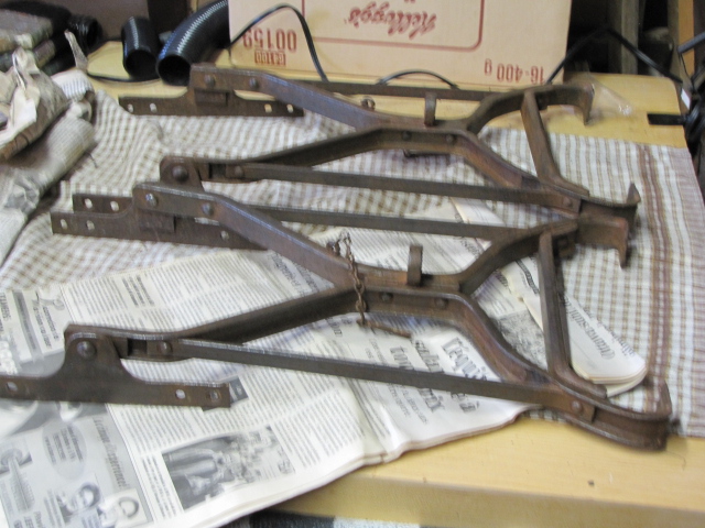

On the picture you can see two pieces
they are two legs for a bench to sit on ...
I just finished taking off all the paint and now I would like to rust proof them.
Because of their size, I cannot immerse them in EvapoRust like I usually do ...
Can evaporust be applied with a brush and protect as much or does it have to be immersed

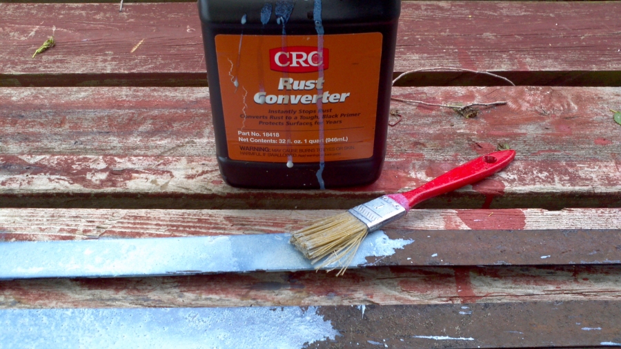

I live on a lake.. I have fought with piers and boat lifts for years.
The stuff that came with the house was mostly non galvanized steal
I use a product called Rust converter by CRC I wire brush the surface to
remove what rust I can first then paint on the RC with a brush. It's milky but dries black.
Works pretty well the oldest stuff I put it on about 3 years ago still hasn't sprouted any new rust.

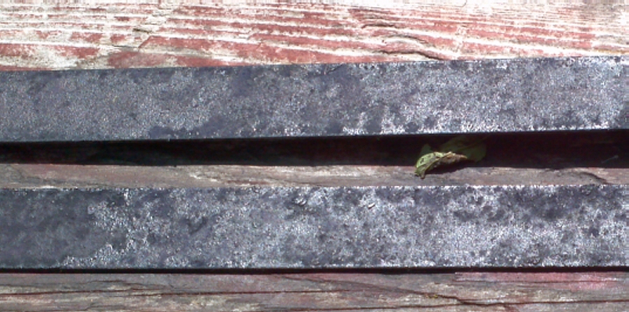

Well I used some yesterday... so since we all like pix
there worth a thousand words and I type slow...
