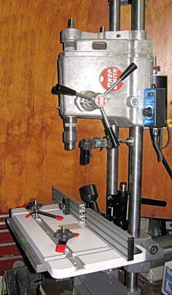

I did something close to this in this post:
http://www.shopsmith.net/forums/showthr ... rill+press
If I had put the head on upside down under the table, it would match (?) tvhorman's assembly suggestion:
[ATTACH]25523[/ATTACH]
Note that the head and table are on the "wrong" side as assembled for this drill press.
- IMG_1328.JPG (65.92 KiB) Viewed 4961 times
Peter
