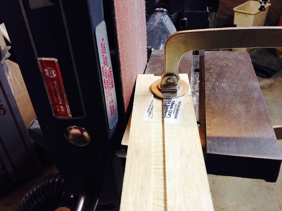

Here's a photo of the set up, transferred to the belt sander.
[ATTACH]25634[/ATTACH]
Imagine this same set up on the disc sander and you will understand.
