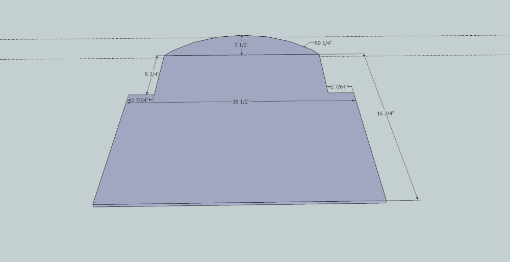

Storage is always a problem for me. Attachments for use with the dust collector were often where they don't belong. Problem solved.
[ATTACH]25983[/ATTACH]
Beneath this shelf, I store a box full of dust collector attachments.
This also prevents the dust collection bag from getting snagged on those exposed screws.
DC3300 Bottom Shelf (Custom).png (39.92 KiB) Viewed 5319 times

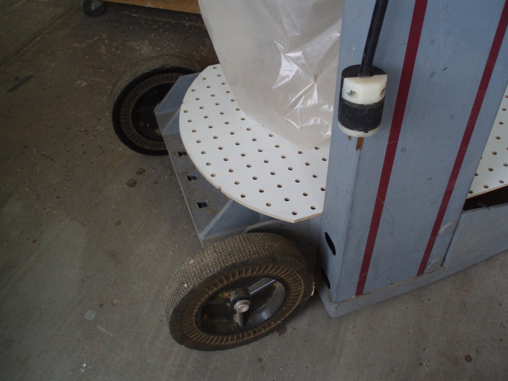

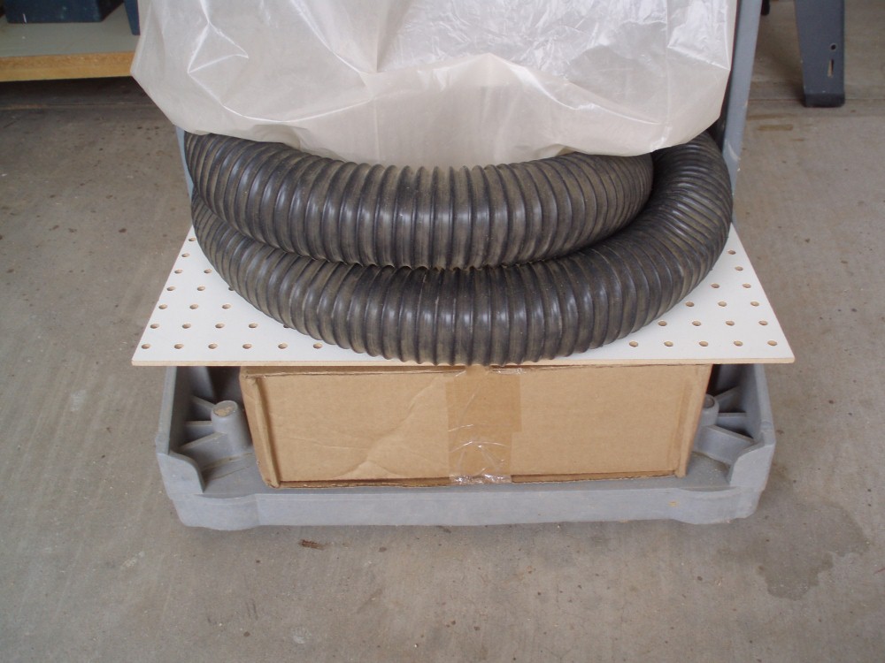

Not quite finished but here it is.
[ATTACH]25986[/ATTACH]
[ATTACH]25987[/ATTACH]
[ATTACH]25989[/ATTACH]
510_520 Dust Collector 017 (Custom).jpg (145.53 KiB) Viewed 5292 times
510_520 Dust Collector 018 (Custom).jpg (146.66 KiB) Viewed 5292 times
Dust Collector ShelfRear Trunnion 003 (Custom).jpg (141.28 KiB) Viewed 5283 times

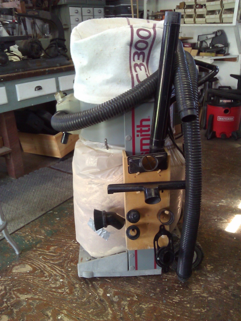

I made a storage device based on SS plans (from somewhere, many years ago). Can't figure out how to poste a picture.
WP_001083 DC Complete (768x1024).jpg (453.37 KiB) Viewed 5154 times
The purpose of the radius is? Perhaps to let it fit at the bottom when not 'storing'?
JPG40504 wrote:The purpose of the radius is? Perhaps to let it fit at the bottom when not 'storing'?
The radius was intended to be a way of making the shelf clear the wheels. My wheels move back and forth maybe a 1/4" or more. If I brought the shelf straight out, I had interference with the wheel.
