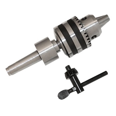

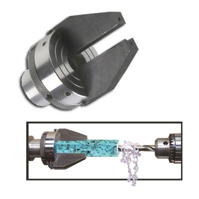

[ATTACH]26368[/ATTACH]
[ATTACH]26369[/ATTACH]
Ok did these photos attach?

[ATTACH]26370[/ATTACH]
These are what I thought might work for lathe pen blank drilling
