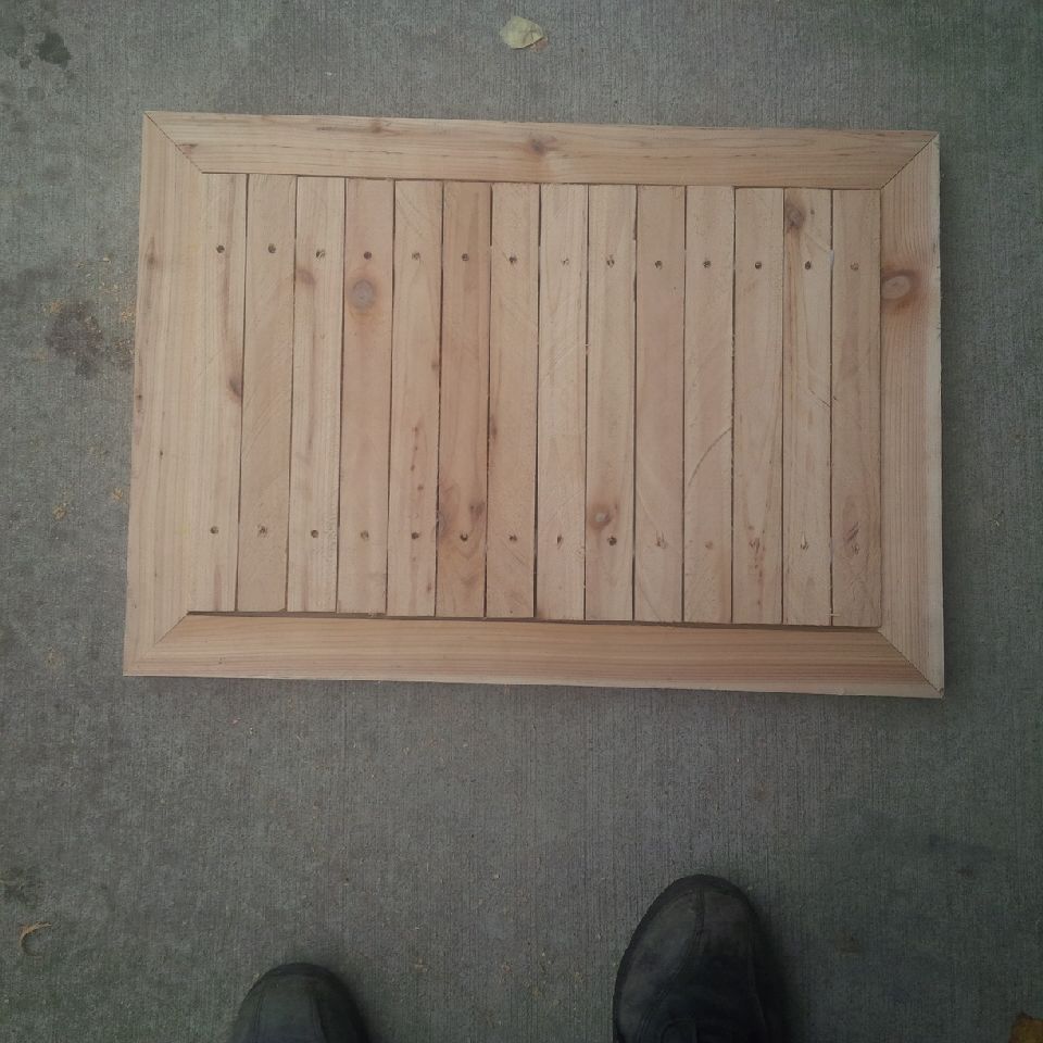

Here is my first project with my shopsmiths. The slats are supported by a dado. Much ripping in the cut diagram, all from a single 8 foot 2X6.
The holes on top are for appearance.
Materials needed:
1 2X6X8'
30 1/8" thick plastic washers
2 30" 1/4 threaded rod
i used casing nails to hold the corners together.
Materials needed:
1 2X6X8'

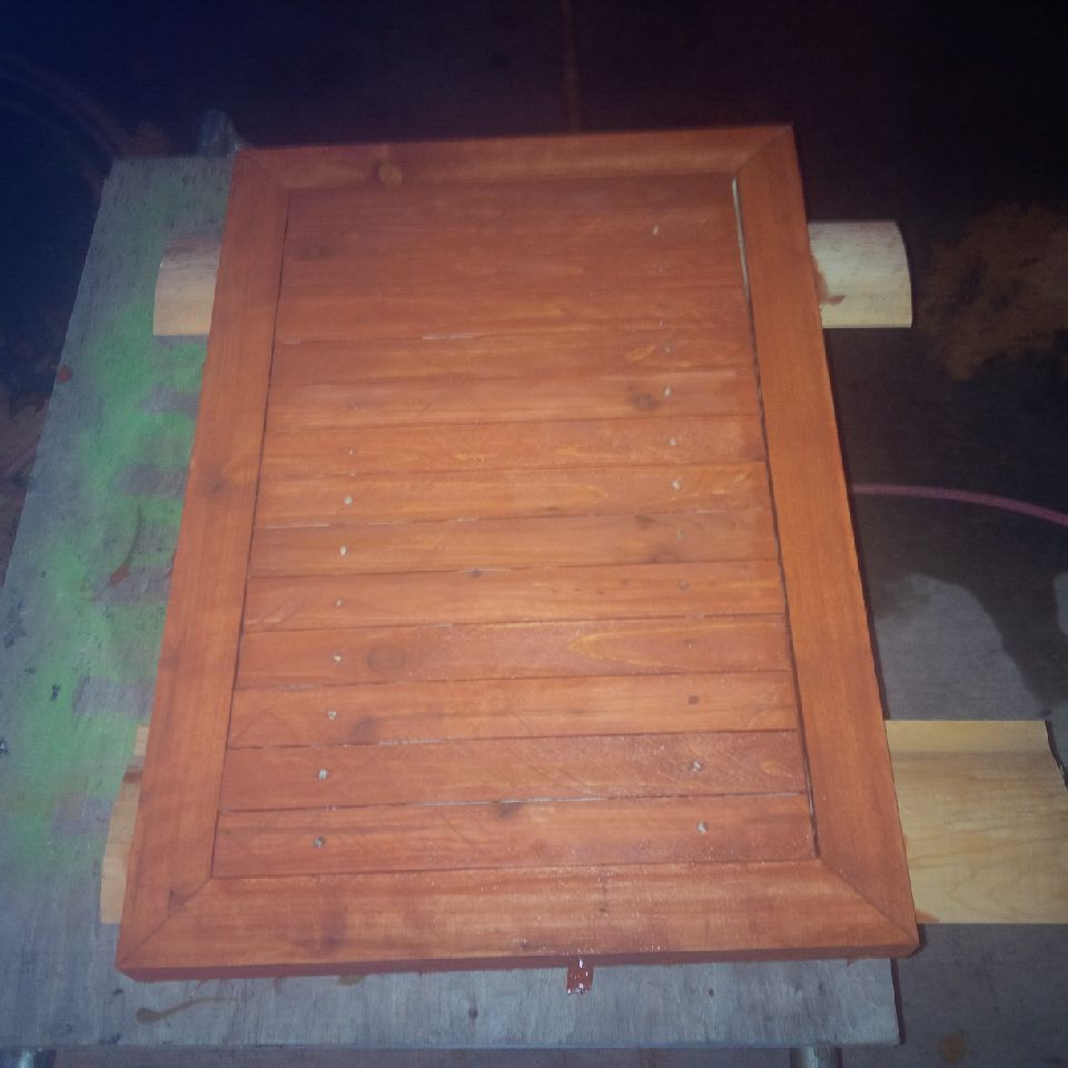

I am applying some "orangish-brown" semi transparent deck stain to it. It will kind of match the brick of our house. I just lightly sanded it, as I don't want an outside doormat to be smooth.

And here is the picture stained.

Wodeck, Devils advocate here, been there done it, nice job, but the miter joints will fail on the border unless you reinforced them some how. Splined/ect.
