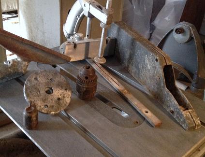

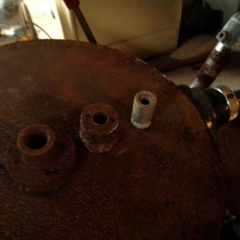

Hey guys here is what I got when I got my Dad's Lathe, I am working on cleaning this stuff... Bare with me while I am not use to forums..but I'll get better, here are attachment pic's of what I have. Can you guys also tell me how I attach blade for the tablesaw or am I missing something?
