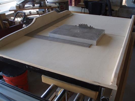

I thought I had done a blow-by-blow on the building of a cross-cut sled but I must not have. I don't even have good photos of the sled that I use all the time. This is the best I have. It is built entirely of 1/2" baltic birch plywood except for the runners and this sled uses runners purchased from Shopsmith. Making the sled using wooden runners would be just as good.
One of the more important features of a sled is its' adjust ability. If the fence is not square to the blade when you are using it, the sled is about useless. For that purpose, I find this post to be very informative.
http://wnwoodworkingschool.com/5-cuts-t ... -cut-sled/
- Crosscut Sled (New) 201 (Custom).jpg (28.88 KiB) Viewed 7199 times
