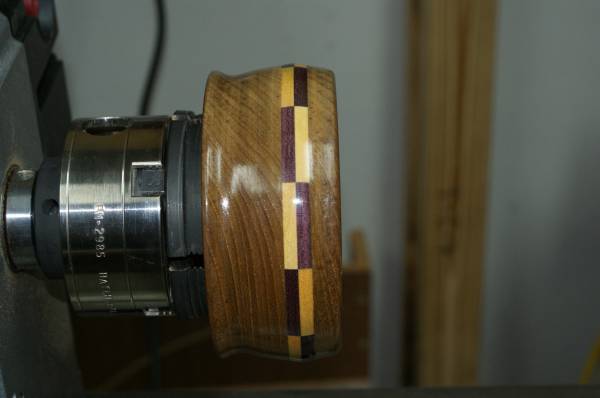

bowl with ring one.jpg (70.29 KiB) Viewed 4811 times
