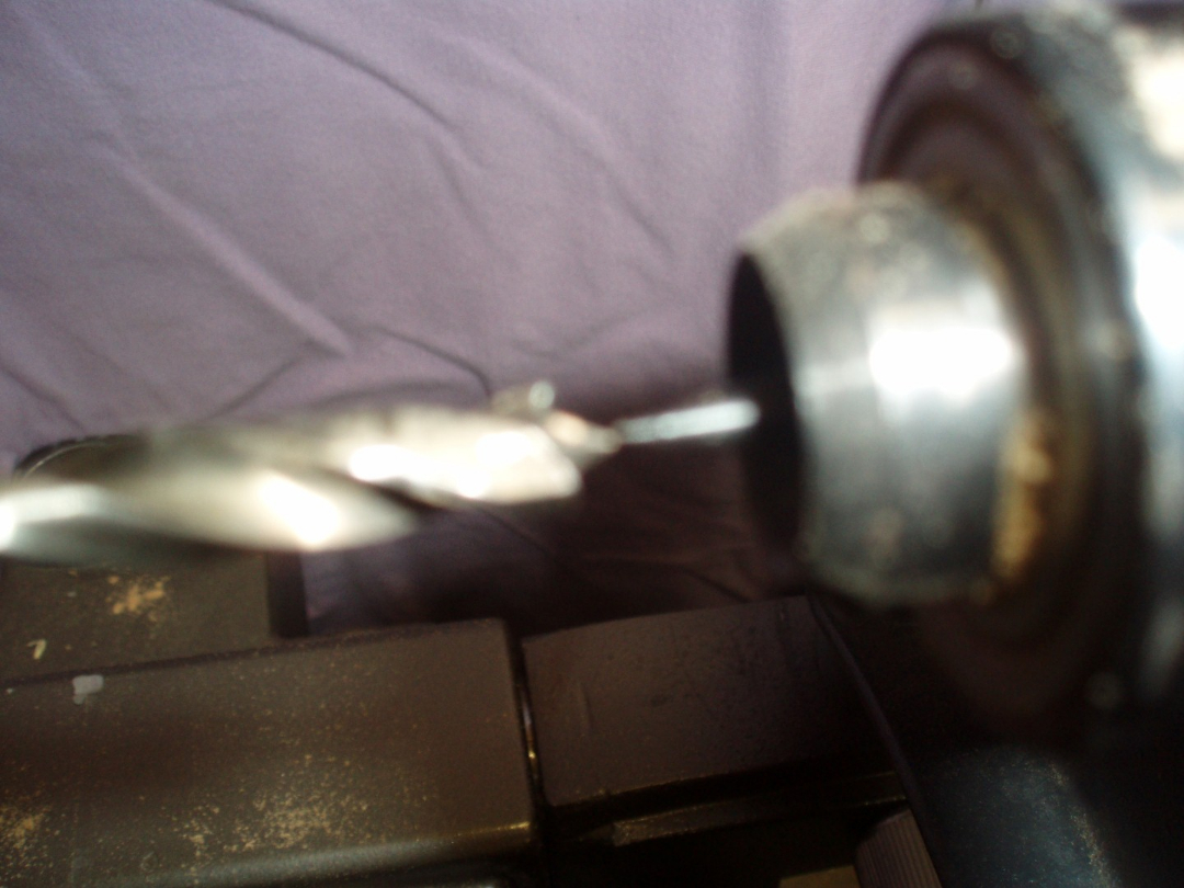

These photos are very good but I think they show the error.
Not quite tip to tip with headstock lock disengaged.
Align the Head Rest 006 (Large).jpg (654.67 KiB) Viewed 4037 times

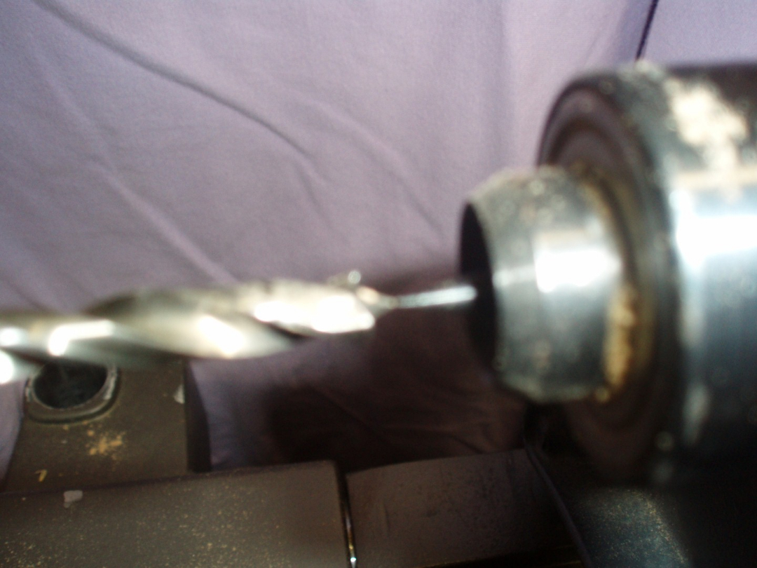

Locking the headstock brings them tip to tip.
Align the Head Rest 007 (Large).jpg (650.03 KiB) Viewed 4037 times
