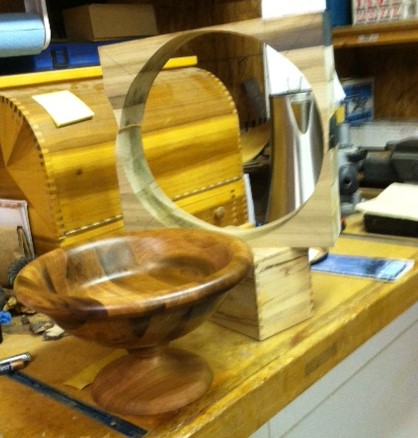

NUTS! This is a bad rumor!
I've used water based finishes many times over an oil based coat. It is standard in my shop.
The chest in my icon is an example. http://www.shopsmith.com/ss_forum/viewt ... 090#p64090 - Scroll down to the 5th post it says what the finish was.
Also this -
bowl & remainder of bowl blank (2).JPG (68.21 KiB) Viewed 5528 times
Also the wood chest at the back of the table.
