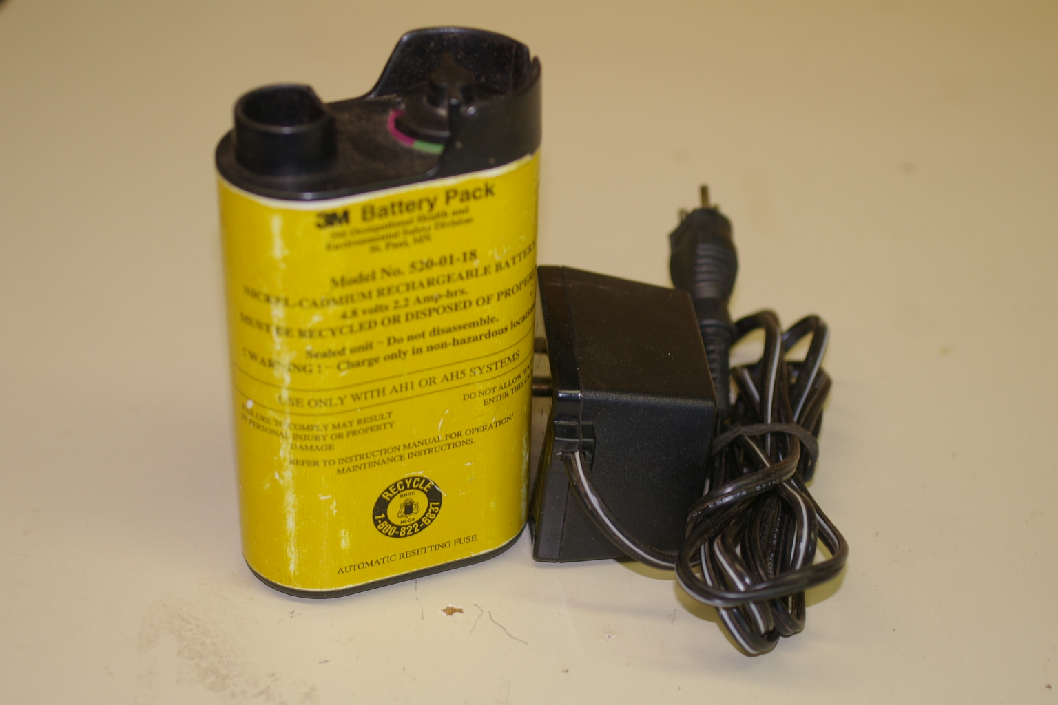

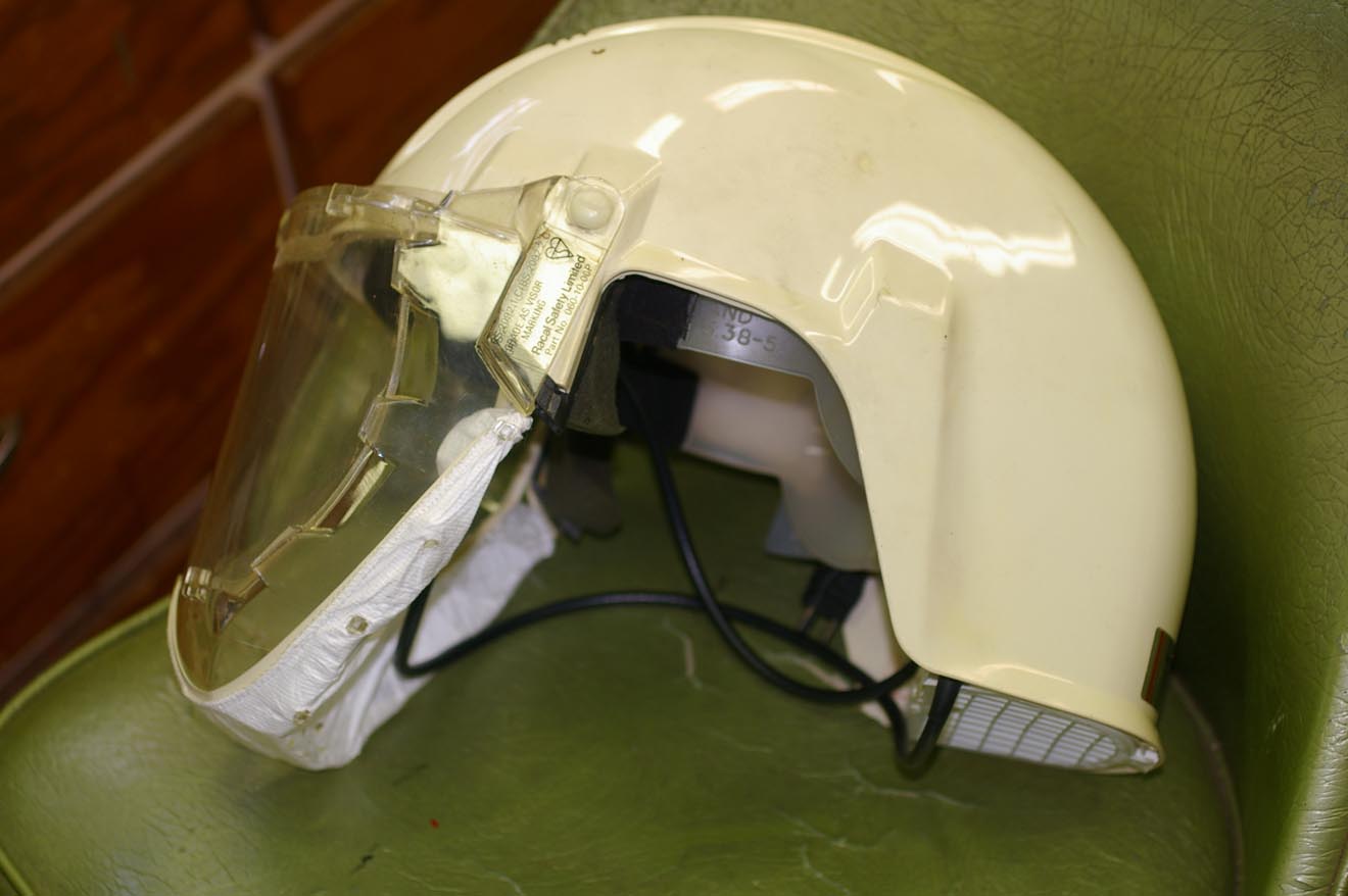

Here is what I use. I bought this almost 30 years ago. Had to replace the battery once.
Don G
Don G
- IMGP3034.JPG (485.13 KiB) Viewed 8583 times
- IMGP2920 re a.jpg (91.54 KiB) Viewed 8583 times
