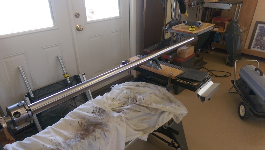

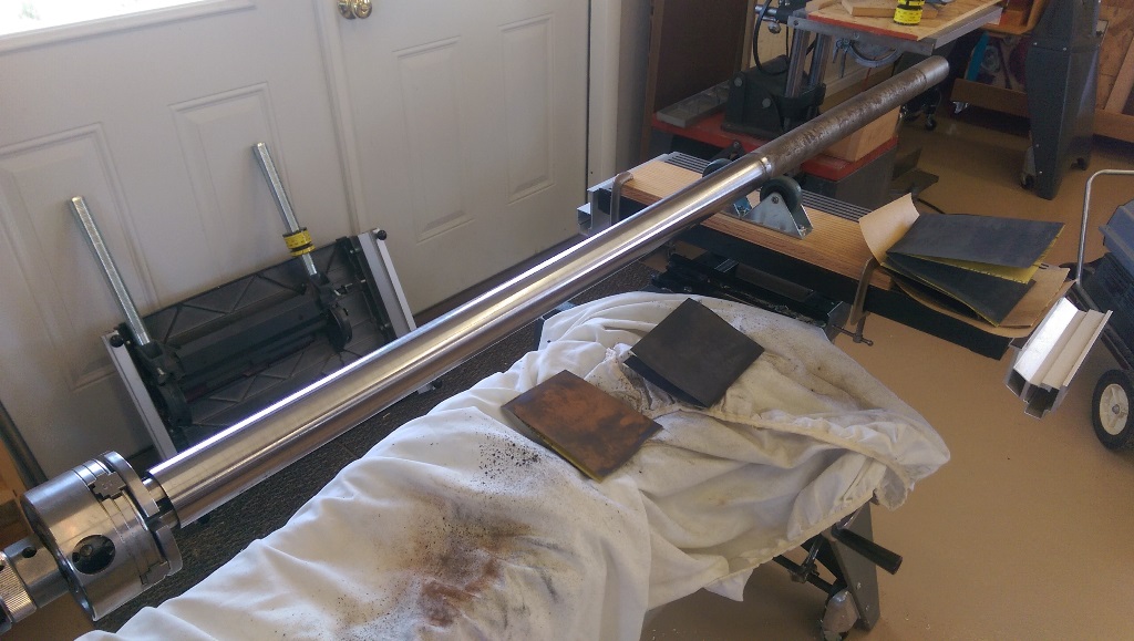

However, I chuck them up in a SS in lathe mode and first clean them with mineral spirits . Then progress through the grits of wet/dry paper starting at 220 or 320 depending on how bad they are up through 600 grit and then #0000 steel wool and then paste floor wax. Depending on how badly pitted they are you won't get them show room shiny but they will be perfectly smooth and functional.
- IMAG0096.jpg (193.82 KiB) Viewed 5149 times
- IMAG0097.jpg (185.27 KiB) Viewed 5149 times
Thanks, you've relieved my mind by showing me that using 600 grit wet/dry and then crocus cloth will not harm the tubes.
However now you have given me another question to ask. How do you add the attached pictures?
Thanks again,
GeorgeM
