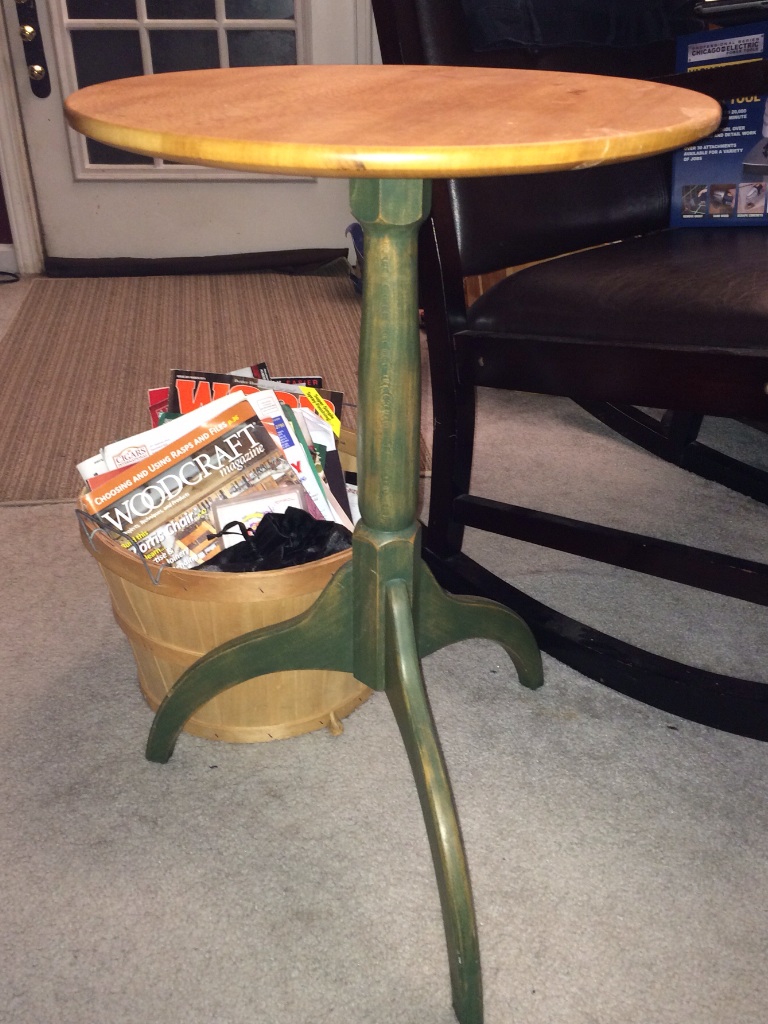

I did a quick count of these tables at our house and noticed that we have three of them in service: one in each of our spare bedrooms and one in the living room. All of them were from some stage of experimentation for the FOW class while I was at shopsmith. Here's one made of poplar and as you may be able to make out, it has the dreaded "Wagner Safe-T-Planer" flats were the legs are cowled to the post. My best guess is that this one dates back to 1989 or so. You may also note that this was made during a period of time where I had the students face plate turning the top as well as a round support beneath. This turned out to be a bad idea as many firs time turners struggled with the large top and more than once turned so deeply their tops had decorative wood dowels protruding through the top. This was also prior to an adjustment to my leg template where for some reason these legs are a bit to "squatty". Scott

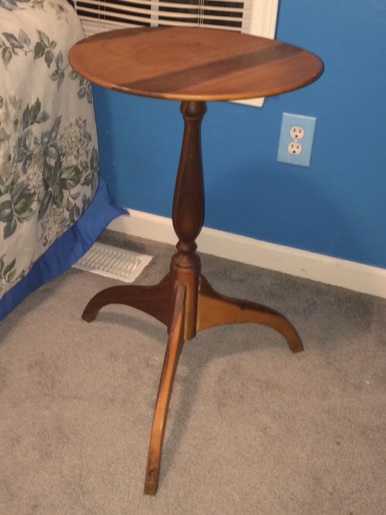

Here's another version of the table that I had students in the FOW class building around 1995. This one is very similar to the one I made from the 2X4 except the top is a tad larger and the support beneath the too is round. By this time we had stopped turning the top, so we could go larger than the 16" capacity of the Mark V, and we were using the Shopsmith Router System in the class so the underside edge of the top was shaped using a raised-panel bit. This table also has dovetailed legs that I believe we produced using the Shopsmith Joint-Matic and was made from poplar with a lovely quarter-sawn sycamore top.
