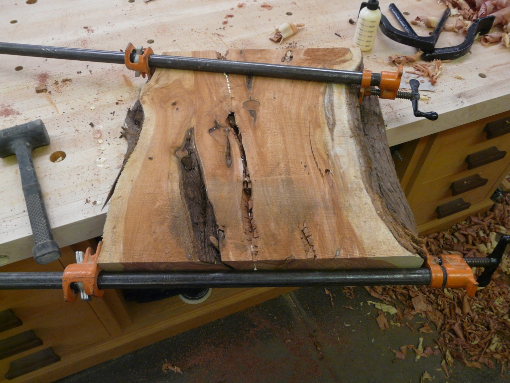

This is where the fun started.  Seems the entire center of the slab was rotten and it broke in two when I picked it up.
I decided to try to put it back together with some large dominoes since this was the part chosen for the top.
More to come. :)
Re: Live edge vanity
Posted: Sat Jun 13, 2015 3:51 pm
by mbcabinetmaker
It felt pretty solid when I clamped it up so things were looking up.
