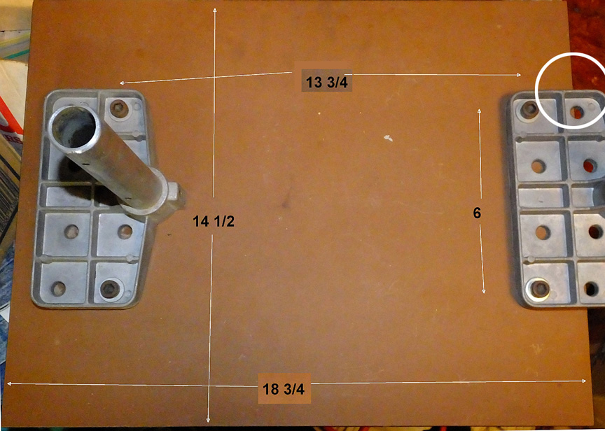

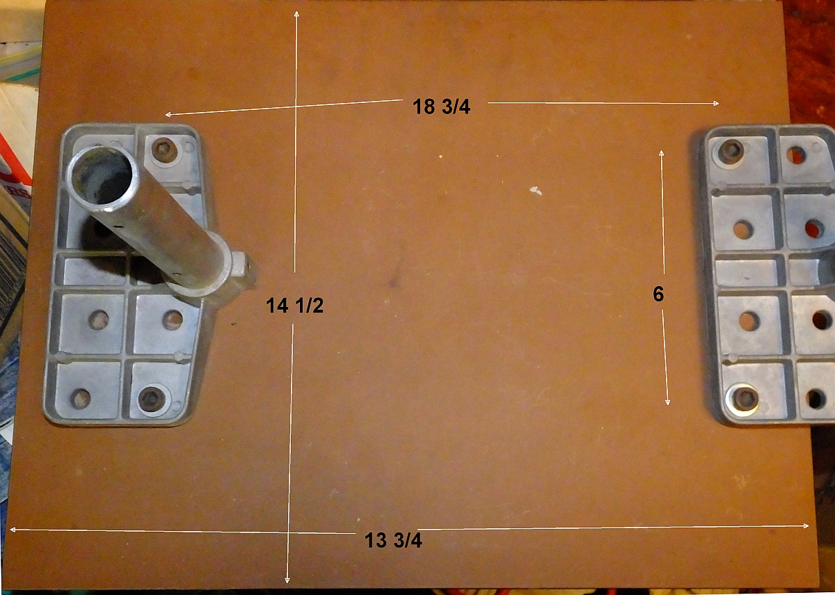

REVERSE THE 18 3/4 AND 13 3/4 :o :o :o :o :o
LATHE DUP TABLE DIMENSIONS.jpg (714.52 KiB) Viewed 9159 times

Re: Lathe duplicator table
JPG, something is amiss with the 18-3/4 and 13-3/4 dimensions, for sure. :confused:
BuckeyeDennis wrote:JPG, something is amiss with the 18-3/4 and 13-3/4 dimensions, for sure. :confused:
JPG wrote:
Whoops!!!! They be reversed. Original post 'addendumed'. :rolleyes:
algale
Posts: 4841
Post by algale »
I'm not sure the dimensions of the table are particularly critical: as long as it spans the table mounting posts/brackets in the front to back direction it can be any width you want. A narrower table will require moving the carriage more often than a wider table if you are duplicating a long spindle but will be easier to store.
