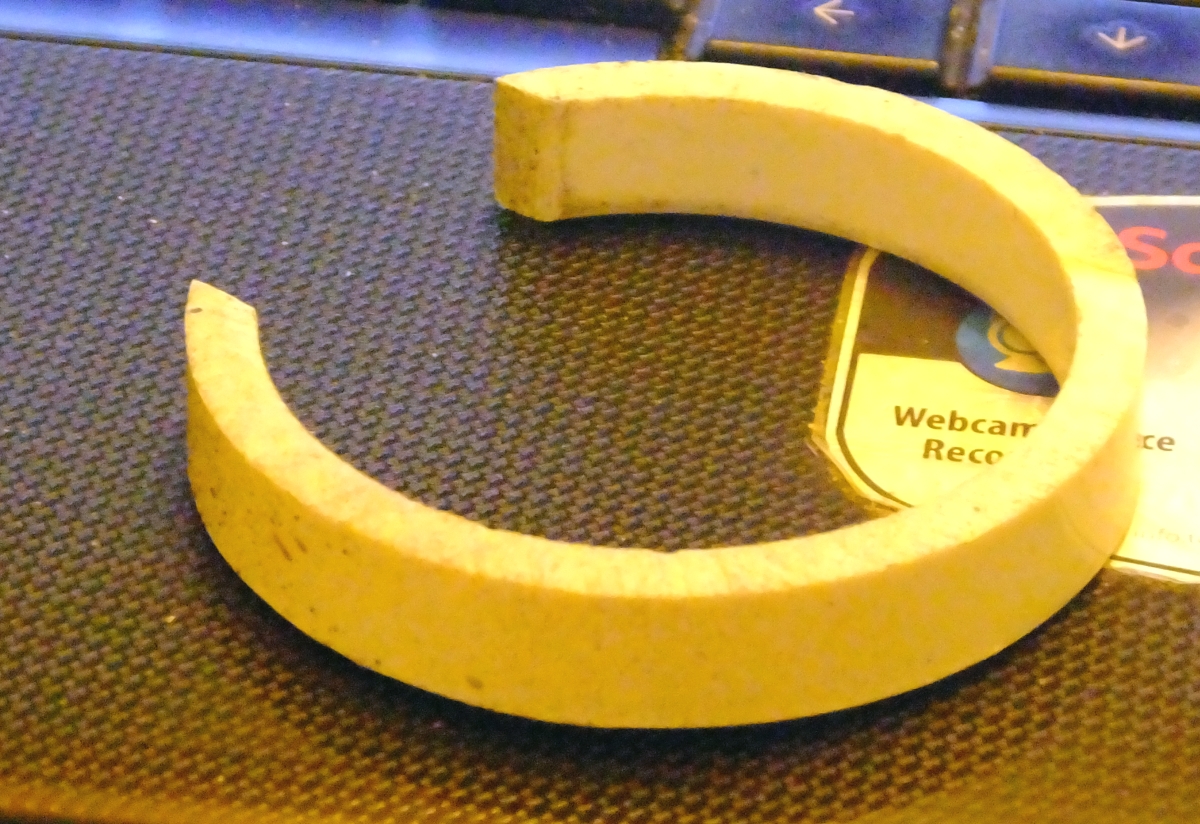

Re: Today's dumb question
3/8"
M5 SPACER.jpg (733.31 KiB) Viewed 6932 times

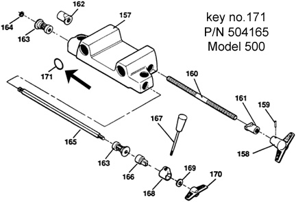

If you want the official version, the next time you have a more substantial order, you can add one or two Carriage Stop Rings to your order. Part 504165 for the 500 - $2.85/ea. The only reason I say to get two is that my blade/slot never lined up, so I ordered a new ring, which was about 3/8" wider than the one on the machine (510/520 version is wider than the 500 version), so it was either always too small, or I or the previous owner did something to "shrink" it.
When I unpacked my 510, I thought the rubber stop ring was part of the packing, so I sliced it and then discarded. I operated for years without one.
Finding out that it should be there, I bought another and put it on. After a while I slit that one so I could take it off and put it on without any mechanical freeing of the way tubes.
Even with the slit, it works just fine when on the way tube.

Mike907 wrote:If you want the official version, the next time you have a more substantial order, you can add one or two Carriage Stop Rings to your order. Part 504165 for the 500 - $2.85/ea. The only reason I say to get two is that my blade/slot never lined up, so I ordered a new ring, which was about 3/8" wider than the one on the machine (510/520 version is wider than the 500 version), so it was either always too small, or I or the previous owner did something to "shrink" it.
As shown on the SS website that part number appears to be an O-ring. The actual part is more like a tube, 2 or 3 inches long, right? (I remember seeing a shot of it on one of the on-line videos but I watched so many I don't remember which one it was in.) But I will take the advice offered to merely measure the distance and proceed accordingly.
