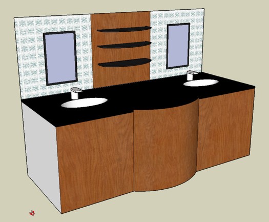

I too was having a rough time with it. Then I spent a couple of hours with various online tutorials and found a lot more power than I thought would be available for free. I'm using free sketchup to design a new bathroom vanity for us.
[ATTACH]31[/ATTACH]

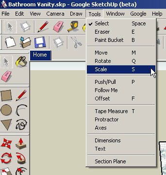

But I found out I had used the defaults and it was sized as big as a house. Then I found the scaling function. The tool bar and icon for scaling looks like this.
[ATTACH]32[/ATTACH]
Or you can get to it from the menu.
[ATTACH]33[/ATTACH]
I'm currently drafting all my projects now in sketchup. Its fun and gives me a lot better idea of what it's going to look like. Now I've got to figure out how to draw drawers on that curved front.
Good luck,
Hal
