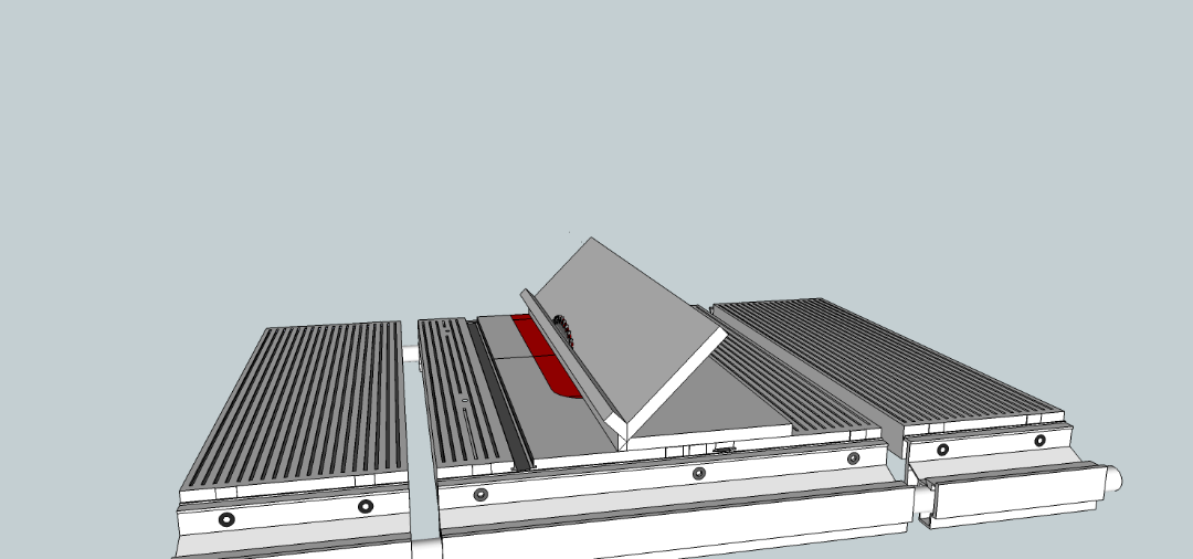

I recently had to rip a bevel on the edge of a narrow piece of stock. Being a narrow piece, I couldn't think of a way to clamp it safely to cut with a hand-held saw. I decided to use the table saw, but to get the main table to tilt 45 degrees, I had to remove all of the table saw blade guards! Seemed dangerous, but I only had to make a couple cuts and managed to survive with all my digits intact. Is there a better way to do this with a 510 table?

]I understand your concern and I have done exactly what you did. However, I was later faced with a large number of pieces that had to be cut the same way. Rather than tilt the table, I built a jig so that I could tilt the work piece. If I still have it, I'll post a couple of images. I thought it worked quite well but it only worked for a specific size work piece.
This is not a sled. It was clamped to the table. The slot for the blade was cut by lowering the table down onto the blade allowing it to cut its' way through the jig. There is a runner in the miter slot to provide some stability.
Hope this gives you some ideas.
[attachment=0]Main Table and Two Floating Tables with Bevel Jig.png[/attachment
- Main Table and Two Floating Tables with Bevel Jig.png (153.09 KiB) Viewed 7176 times
