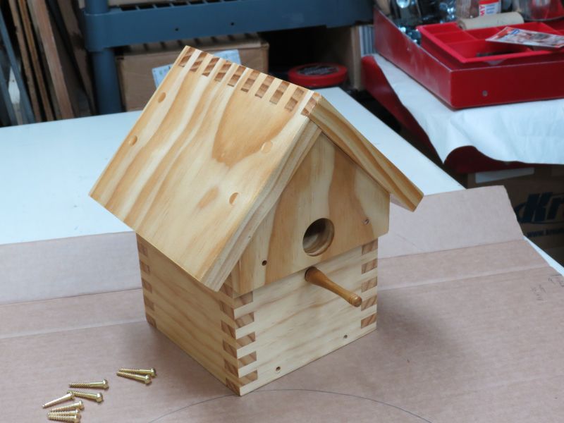

I did a bird house using box joints just to play with the incra box joint(ibox) jig I purchased. That seem to work well and now I have that in my collection of tools to use. Before that I would make a jig up and use it once then make another when I needed to make more joints. I still have a couple of them laying around here somewhere. That was the problem, I'd loose them when I needed them so it was faster to make another then spend too much time looking for the last one.
Anyway this is the bird house:
