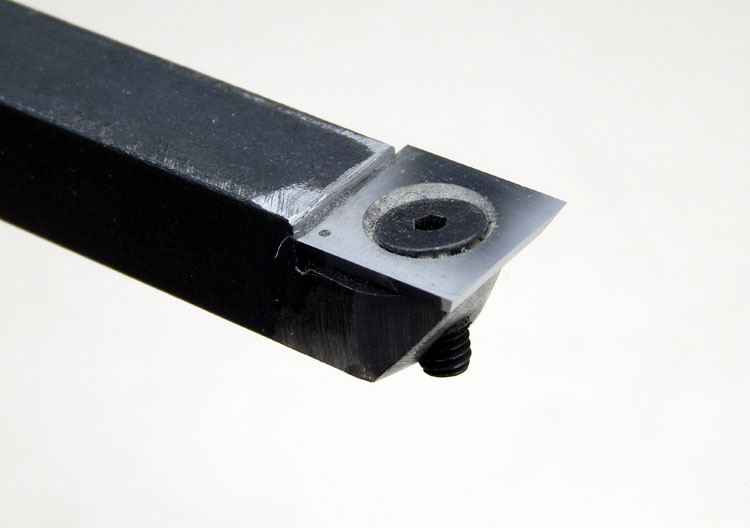

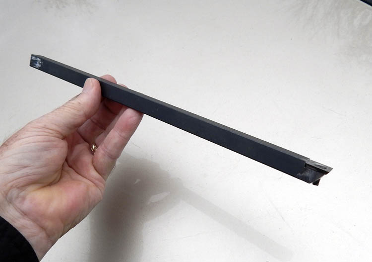

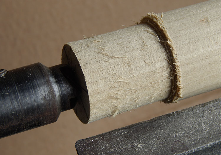

I made a carbide chisel. It is wicked sharp, just sliced my thumb on it. But using it to turn a spindle was not satisfactory. Is there something wrong with the chisel? Wrong type of wood (poplar)? Headstock turning wrong speed? Or do I just need to turn the diameter and then sand smooth?
I was gonna use poplar for the chisel handle. I tried turning the dowel for practice.
12 inch chisel bar

First, it often looks like that with a "square edge" carbide blade. A blade with the the slight convex edge works better for a smoother cut.
It looks like you may have the tool rest a little off. The cutting edge should be at mid line of the project diameter
For me, speed is less a consideration when using carbide versus a skew or gouge.
Though I really like carbide, the reality that "I" know is that a conventional skew cut with a sharp steel blade will give a smoother cut than carbide, though carbide can result in a nice finish, just not as smooth.

Is the piece running true? I get results like that when the tail stock falls out of alighnment with the quill in the middle of a project.

There are several videos on YouTube. I studied them. I bought a pilot drill and tap set for 8-32 screws. I bought a cheap angle grinder at Harbor Freight. I used the grinder to make the shelf for the carbide insert. I also used it to slope the bar to match the angle on the insert. The cuts were ragged so I dressed them with the sanding disk on my Model 500, and used a flat file also. I have a cheap drill press and tried to drill the pilot hole but it was a bit off (see photo). I carefully used the tap and then made a slight countersink for the mounting screw. I screwed the insert in place and went to the lathe.

Lets see if this makes any sense. The tool rest should be really smooth and flat. If not then ever little nook and cranny telegraphs to the work piece. In the picture yours looks like it needs a lot of work. Could just be the picture?? Anyway my first suggestion is to get it squared away as it will not matter what tool you use it will be messing you up.
You also need to round the tool bars edges. If not you will mess up then tool rest again in no time at all.
The screw that goes through the cutter needs to be trimmed flush with the tool holder. The first thing is to make it shorter then grind away the remaining excess flush. The screw will still work.
As was mentioned the cutting edge of the tool should be at the midpoint of the work piece. The handle should be held so it is level with the floor.
As was also mentioned, the cutter you have is a square so the two none cutting sides can dig in ever so little and that produces this little tiny spiral looking cuts as you traverse along you cut path. They make cutters with a slight radius that makes this problem go away. You can cut with the square cutters but it takes more skill and paying attention to detail.
Next it looks like you are turning a dowel...... At this point I think this is not a good idea, in fact a lot of your problems are due to this I think. Go get some pine 2 x 2's and start learning to make them round.
We can't see the rest of your set up or know what speed you were turning at but those other aspects can also be issues. As an example assuming the diameter is less then 2" a finishing cut would be made at "T" 4250 rpm. Shaping would be "N" 2590 rpm and ruffing at "C" 910 rpm. Better finishes come at higher rpms.

I have had the results you are getting. Ed has make good suggestions. I would add one thing: How aggressive are you in making the cut? One sees a lot of videos and live demonstrations where the turner is hogging out vast amounts of material in a short time. It make s for an impressive demo but the cuts will look like the one you have at the end. A slower much less aggressive cut will result in a smoother outcome. I look it as using course sandpaper: removes a lot of material quickly but leaves a rough surface. Fine sandpaper: less material removed but a smoother finish. Agree with Ed that a slight radius cutter will give better results. I find I have better control, much less aggressive. Good luck.

The Roughers have to be kept to be kept flat on the tool rest and stay level to the floor and as ‘Benush’ said your tool rest is a little off.
The interface of the cutter should be midline so the tool rest has to be lower. Easy Tools will tell you that all of theirs are designed to be used with the tool rest set so that when the tool is held level the top of the cutter is on center line of the stock. You just have to keep it level to the floor and flat on the tool rest for all types of cuts to know what a joy in turning can be.
As Ed points out, the tool rest has to be flat and smooth (and waxed) as indeed any micro chatter that in introduced will telegraph to the cutting tool edge, and be amplified due to the long lever and fulcrum that exists from the tool to the stock itself (as well as back to your hand) and he reiterates that a slight radius cutter is the preferred by far.
One other point is the Quill itself can be a single bearing quill, and if it has a worn bearing, can introduce some run-out into the equation. A two bearing Quill with rock solid bearings and a spot on live center can help too.
Once you have resolved those issues, I suggest that you try a variety of stock like walnut, cherry, as well as starting with pine and other soft woods as you build your technique. Moisture content of the stock can reveal some quirky things as well.

I have a set of carbide-tipped tools I use for pen making, especially when I turn buckthorn, which is very hard and dense and tends to dull steel very quickly. What I've learned is that the carbide tools actually perform much better when used for shearing rather than scraping. I know someone else who uses carbide to turn pens and has found the same thing. I usually use a tool with a round or convex tip rather than square, but with practice, a square end tool could probably be used the same way. You want the tool tilted up on edge, with the edge at maybe 45 degrees to the floor.

PS Just have to add one thing. The carbide cutters are excellent if you are doing any segmented work. The dowel in the first post will have the grain direction change every 90 deg and cutting across the grain will cause tear out. With segmented work because the way the individual pieces are cut and assembled you only cut face or side grain and the shavings come off the work in nice long shavings.
